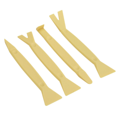

So do I make a 40 mile round trip to buy a trim removel tool or is there another way I can remove the plastic Tabs that that hold the liner to the bottom of the hood without tearing them up ?

I only pulled 3 of the retainer tabs out and get to the hoses. I had the trim removal tools and still broke 2 of the 3. I'm ordering some more of the tabs to replace the ones I lost. I have a 2014, so our trucks are about the same age. Get new retainers as linked on here and don't worry about breaking them. OH... the spray nozzles will probably break as well. When I tried to remove the original ones, they disintegrated.

Used a plastic pry tool for the hood cover. No issues off and back on.

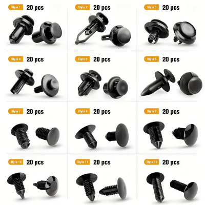

GTyankee
Nov 2, 2020
12,391
17,460
El Cajon Calif. 92021
3.0 ecodiesel
My local NAPA store is a decent size
They have bags of different plastic clips & pins, ford, GM, Chrysler, etc.
buy a set of trim tools, from just about any where, like H.F.
don't try to grab the Head
Shove the tool between the hood & insulation, then pry
do not try to just grab the head, the plastic is likely to break
GTyankee
Nov 2, 2020
12,391
17,460
3.0 ecodiesel
TYPE 6 pin, is one that i have NOT tried to remove
7 through 12 clips are more like what my 2 Rams have had

If you have any auto parts stores around you they should have the trim tools. I got a set from harbor freight for like $4 and they look exactly like the ones GTyankee posted

\I found a tool in my Dads old toolbox that had a vee cut in one end of it and used it to get the plastic rivits out then took the heat shield off.
