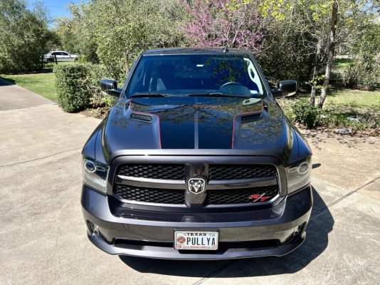

After we installed the aftermarket 3M black decals on my truck, we installed PPF on top of the decal to protect it. You might think about that if you decide to remove the current decal and put a new one on.
From the OP's description of things that would probrably be the best way to go.
Instead of trying to save what really can't be saved, just replace it and be done with it.
Any competent body & paint shop should be able to do it and do it right - Or just do it yourself if you want BUT realize the end result's installation quality is on the OP or whomever does the work.
However I also understand it's really a cosmetic issue, I seriously doubt the OP is in a rush to get it done; so my suggestion is look around, see how much a decal and installation would cost - They'll know what to do from there I'm sure.

I had a friend who installs PPF and wraps professionally help(actually he did it) with the install of the decal and then the PPF. Sometimes it's a lot cheaper to realize and admit your limitations--LOL-
