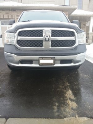

I have a 2014 RAM SXT. I currently do not have fog lights and want to add them. I've seen guys doing a bumper swap but was wondering if anyone has customized anything to fit in where the tow hooks would be? I don't want it to look like a hack job.

What front bumper do you have? The big chrome one, or the paint matched "sport" bumper?
Your answer to this question will help me provide you with the proper information you need.
It would be best if you could just post a picture of your whole front end, standing in front of the truck so I can see your whole bumper.

Big Chrome one

Sorry, wish I could recommend some lighting but I have no experience with the chrome bumpers.
If I had to guess what would work best for you, it would be the Rigid Industries Fog Light Mounts to mount Dual Pods in each opening. I'm pretty sure they make a kit for the chrome bumpers.
They're not for your bumper, but I'm sure you could make them work with your stock tow hook mounts.
Good luck and let us know how they turn out.

I'm pretty sure mopar makes a kit for in those openings on each side of the license plate.
Adding foglights to 2013+ tradesman/slt
I just need to find a few more part #'s but need my computer for them
1500 - Headlight Switch
68189154AA
- Bumper
- Any 2013+ 1/2 ton
bumper with fogs
- Fogs/brackets
rockauto.com
Fogs -
TYC19603900/19604000
Brackets-
- Jumper Harness
68046303AC
- Sales Code
- LNJ
2500/3500
- Headlight switch
- 68189154AA
- Bumper
- Any 2010+ 3/4-1 ton
- Fogs/Brackets
rockauto.com
Fogs-
TYC19594100/19594200
Brackets -
CH1061100
Foglight jumper
68046303AC
- Sales Code
- LNJ
Sent from my VS985 4G using Tapatalk
https://r.tapatalk.com/shareLink?ur...hare_fid=17770&share_type=t&share_pid=1102027
12sportmc
Oct 21, 2016
797
356
NC
If you click the link it will take you to the actual thread where the guy did the mod. Hope this helps [emoji106]
