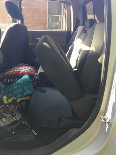

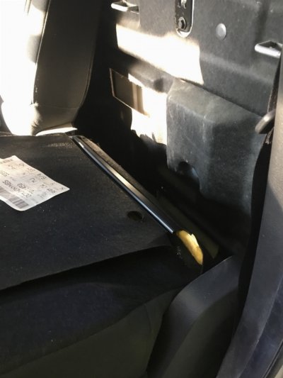

muddy12
Jul 26, 2016
1,030
803
Indiana
Brackets get cut right at the edge of the plastic band. There is still plenty of bracket left to secure the seat to the wall.
Seat back will release only when the bottom is in this position.
Not a ton of storage, but it keeps my 4’level out of the floor.
