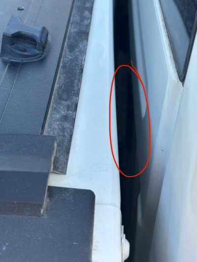

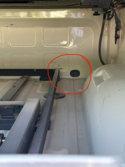

I need to run a small coax antenna cable from the bed to inside the cab. I see there is a small, oval plastic bulkhead at the front of the bed (about 2-3in). I'm assuming this is for that exact purpose because on the back of the cab there is another plastic square (about 6-8in square) only a few inches away...hard to see in the pic. This would get the cable inside the cab. But the back of my rear seat does not fold down allowing my decent access to it. So, I'm thinking I would remove the passender-side rear seat.
Is it fairly straight forward to remove the backseat? Just a few floor bolts...or is it some crazy complicated procedure, as sometimes is the case.

I wouldn't run a cable through that plastic square on the back of the cab. It's quite likely the cab vent you're seeing. You do not want water coming in there :oops:

Use the hole in the firewall, way safer solution.

There should be a couple plastic covered holes in the bottem of the cab you could also come up through. I ran my nitrous line through the floor of my regular cab,using one of those plastic hole fillers.

Thanks for the replies. Yep, I found the two holes under the backseat area of the cab. I can ty-rap/tape the new coax run to an existing cable run nearby and come up right through one of the plugs. Thanks again.
