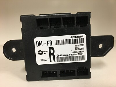

Thank you for responding HarryS, but this does not answer my questions. DOOR CONTROL MODULE FRONT LEFT DRIVER 68424179AC. Is a door module but will it work on my truck with the tow mirrors?

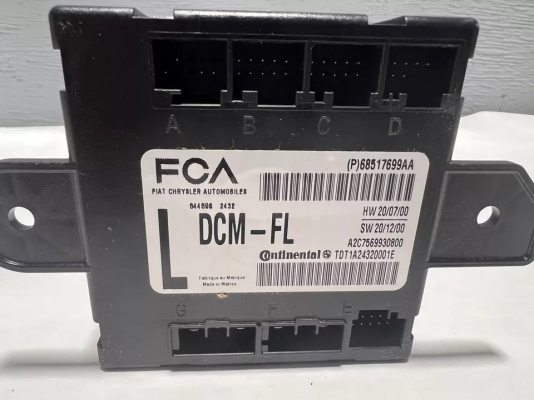

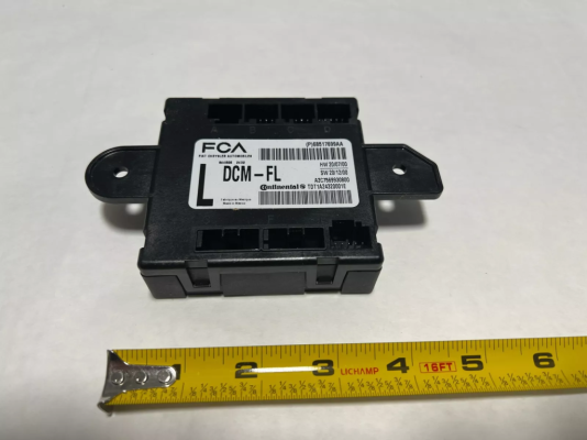

Does anyone sell parts on this forum? I'm looking for new Door Module for Power Windows Folding Mirrors.
A
AlCorr
Dec 28, 2023
10
New Bedford, MA
Can anyone help me get a hold of Benny?
I'm getting all kinds of numbers for the door modules.
