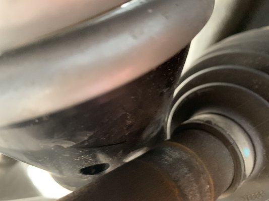

Maybe taking a full lock U-turn and hitting a bump just grazes it. I would jack that tire up have a helper spin the wheel while you hold a piece of 80 grit sandpaper on the axle.

What’s the reasoning for sanding it?

But yeah I’ve got some friends coming to town this weekend and we will ensure it doesn’t rub at any point.

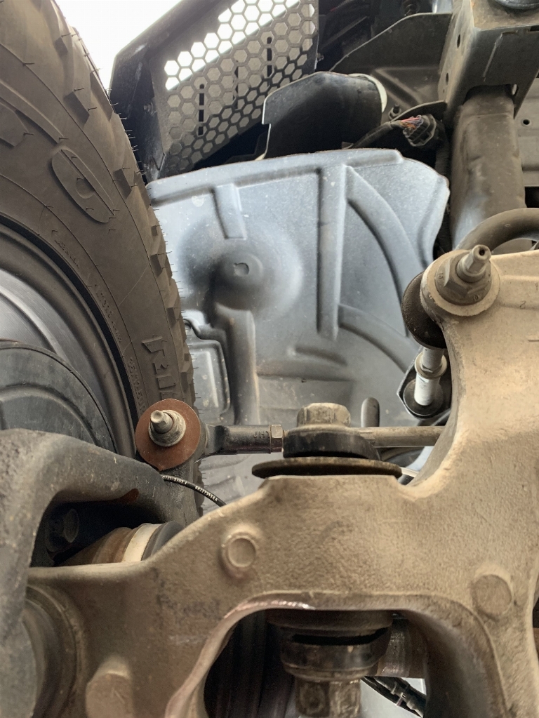

Take a picture zooming out to show the angle of the CV vs the coil spring retaining cone. Weird that it would rub the cone.
If you run sand paper on it that should give you the clearance needed. Its barely touching and will stop it from hitting in the future. I would also take a little black paint and touch up the coil over. They are zinc and clear coated, Fox recommends we wax them with non abrasive automotive wax
Also are you able to move the axle at all? might be a bearing issue allowing it to move. See if there is any wiggle

Its already not touching anymore, at least on rest. The groove has already been worn. No axle movement.
Get in there with some black paint. You don’t want any issues with the aluminum

Oh so coat the worn spot on the aluminum? Got it.
Yes there is clear coat on them for protection, so you want to make sure you get a coat of paint on that exposed aluminum
