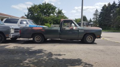

still probably better off just modifying the stock frame. you can lower these things pretty good on just the stock frame especially since you will be going 4 link. i have lowered mine the redneck way in the past and definitely looks pretty cool but definitely probably hard on the suspension(3600lbs of patio stones) lol. could probably get it lower than this with 4 link suspension. with the way the bodies on these are you might even almost be able to get the body to touch the ground before the frame touches
