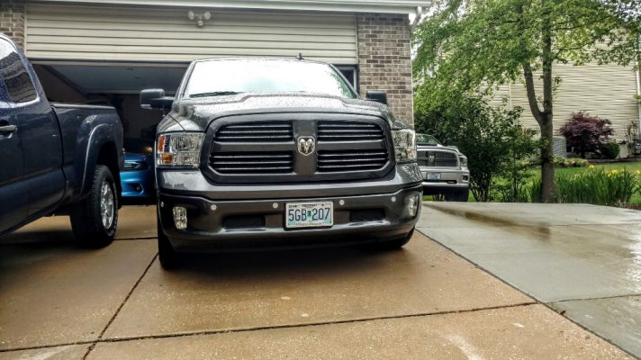

I went with the Outdoorsman front bumper (comes in gloss black) and then had it painted to match the truck. Still need to do the parking sensors and inserts......forgot about those...

thats been my toss up since i painted everything on my truck, my front bumper doesnt have fogs, so do i get one like yours or just get the express/ sport bumper
I'm not really a fan of plastic bumpers.......so this works well for me ;)
