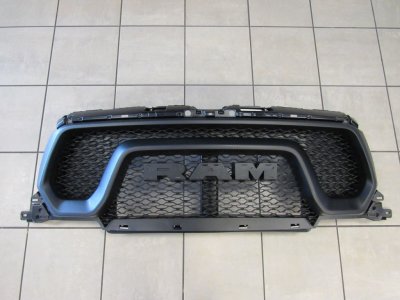

Here is some info to share with you guys. I gathered these since I'm planning to try and swap my grill with a Rebel grill. Who knows if it will work or not but I guess that is the fun of trying it LOL. I'll be on vacation next week and then finishing my tattoo sleeve when I get back so I won't be able to work on this for a while. So the parts I ordered will sit in my garage. If anyone wants to try this before me, please be my guest lol! Initially I was just going to swap for a black grill but that's no fun haha!

The parts guy (Josh Gum) at Avondaleautomotive (Ram Dealer from AZ on eBay) talked to his body shop and they think it will bolt on but with some issues where the grill meets the bumper since the Rebel is higher in the center. If that's the only issue, not a big deal since I can trim if needed. There is a lip along the bottom of the Rebel grill where it ties into the bumper which will probably need to be trimmed. The other potential issue could be the fascia below the headlights since the fascia on the Rebel looks slightly shorter than the Laramie.
If this is a completely stupid idea, feedback is also appreciated!

Yup exactly the points I made. But the Laramie bumper actually has a shallow channel below the grill so it's not exactly flat. Plus the channel extends about an inch in front of the grill. But I'm still thinking I will need to trim the part of the Rebel grill that goes under the Rebel bumper. The fascia below the headlamps could present a challenge if it leaves a gap below the grill but hopefully it's not too bad. As long as everything bolts on, I can deal with any gaps or excess at the bottom. This will be interesting lol. Thanks for the feedback!

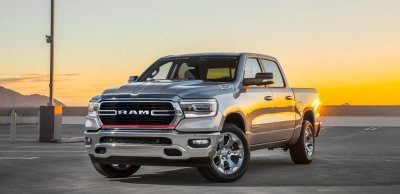

Found this "spy photo" online for a Rebel test vehicle. Seem like the grill won't look bad with the regular hood. I'm also going to go with black RAM letters on the grill.

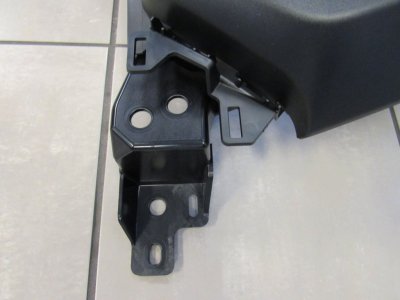

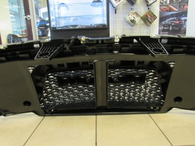

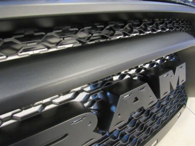

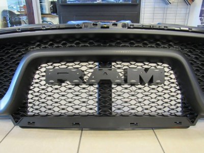

Pics of Rebel grill unstalled. There were some scuff marks so the dealer will send this back and order a new one.
Rebel grill full view.jpg Rebel grill front.jpg Rebel grill closeup - scuffs.jpg Rebel grill letters.jpg

In looking at the Rebel grill, it doesn't seem like you can separate the grill insert. I'll know more when I receive the grill and remove mine but I have the Laramie.

Hm, the more I look at it the more I don't think it will fit the standard bumper. The 4 rectangular holes at the bottom of the grill should be easy to work around one way or the other. The part that concerns me is to the left and right of those holes. I think our standard bumper will hit the grill in those locations. You either cut the grill there or the bumper.
Sucks to hear it was scuffed up. Keep us updated.

This be an interesting project lol. There is actually a channel in the standard bumper below the grill so there is a slight chance that there is enough room. Either way, if trimming is needed then that's an easy fix. May have to trim that entire section off but it's fine because the grill still drops behind it.
My main concern is bolting everything up on top which seems like it should fit.

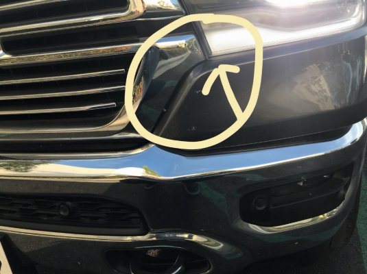

The fascia below the headlights will also be a problem. There is a different angle and the Rebel fascia is about 5 1/4” tall at the bottom interior corner of the headlights vs 6 3/4” for the Laramie. So I would also need the fascia for the Rebel which introduces more problems. So it looks like this is a no go for me.
This is the problem area on the Laramie

After looking at more pics I think it will still work with the headlight fascia of the Laramie. I believe the Rebel grill is shorter and they took the height out of it at the bottom of the grill to fit the Rebel bumper. So with the Laramie you will will have a gap along the bumper and the bottom corner of the headlight fascia.

This is where I see the potential problem. The fascia under the headlight seems to have slightly less material on the Rebel so the Laramie fascia may also need to be trimmed. I think. I haven’t been able to see a 2019 Rebel in person.
