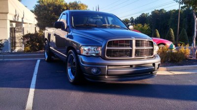

I extended the front lip I had installed on my Ram over the weekend. An after and before shot. The funkiness going on in the first pic to the bottom right is just lighting, its smooth all the way around. All it did was to put a lip jetting out forward on it.

Thanks, It's made from Garage Door Seal they sale at Home Depot. The one I have on underneath is the same, but flipped in a different direction and bolted on in inch increments apart from underneath with a painted aluminum strip sandwiching the rubber to the bottom. I've had it on for a couple of years and still looks like new, and very durable. I just flipped another piece of seal and glued it on with super glue, it welds the rubber together. Here's a shot of the original and while I was gluing the other one on.
