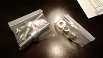

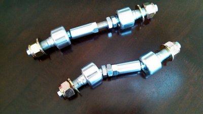

R/T_Fire
Feb 3, 2015
3,432
1,207
Pleasant Grove
Hmmm interesting... not to pick on that but I can see why it failed in that location, I bet if they weren't double articulated with the ball socket on each en it wouldn't fail, and the ball socket needs to have enough pivot in it to account for what movement of the swaybar on its axis. The A-arm and sway bar have differing axis of movement..

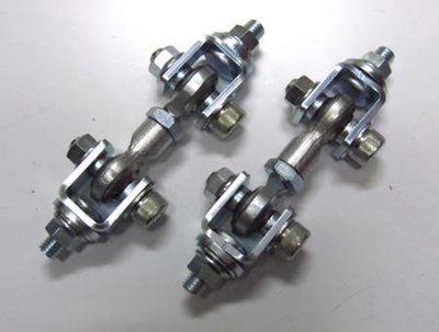

^^^ I like this idea... I have spent some time looking into heims with clevis joints on both ends. If I don't get a workable solution to my broken Chris Alstons, I might play around with something along the lines of these funky-ass things below, lol!
DavidRam
DavidRam
Feb 19, 2014
9,094
3,921
SoCal - Redondo Beach
2012 RCSB
It would actually be simple to piece together:
One male and one female heim, a jam nut, two clevis joints, four cone spacers, and the necessary nuts and bolts. All that times two ofcourse.

I don't know... Just looks like way too many nuts and bolts.
Exactly what I'm thinking. just trying to think how to make it clean and elegant while strong and performing... If I need to put it on the lath and make it myself I will.
I just really want to put it all into CAD before I get crazy so I can model/cycle the components and system and also easily figure out the differences for other suspension drops

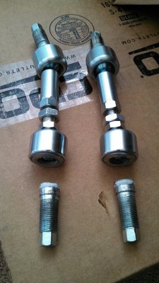

Well, to add insult to injury. I just received my end links back from ChassisWorks... actually, I only received half of my end links. I sent them my entire end links and they charged me $175 and sent me back two halves...
******* ridiculous. I know who I will never do business with ever again, not to mention it took them over 2 months to get them back to me. I am not one to complain, but the Chris Alston service is horrible.
So I have now spent $420 on poor quality end links and I can't even put my truck back together so the guy who bought it can pick it up.
I demanded they overnight me the rest of the parts... We'll see if they step up and at least do that.
