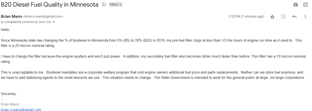

Anyone else having problems with fuel filters plugging on B20 biodiesel fuel? I have to change fuel filters every 50 hours due to plugging and engine power loss compared to 150+ hours before the State of Minnesota passed a law mandating ONLY B20 sold in the state.
Which of course was due to corporate agribusiness lobbying (read: bribe) of state legislators. Prior to 2018, they mandated B5, which didn't seem to make much difference.
No, I don't store fuel and run the engine multiple times per week under heavy load. I also use performance and preservative additive (Hot Shot's Secret).
I wrote the state a nastygram if only to protest:
