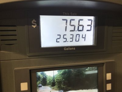

Drove home from SoCal last night, roll up to a pump about 40 miles away from home, truck says 10 miles till E and the fuel gauge is way past E. I was actuallly a little worried, so I decided to get fuel. But what do you know, damn thing only took 25 gallons..still had 7 gallons left. I am going to start researching this, and asking for a fix at my dealer it really pissed me off last night. You can see in the pics in the “ Range” once it gets below 10 miles left it goes to “ fuel low” instead of a miles read out.
