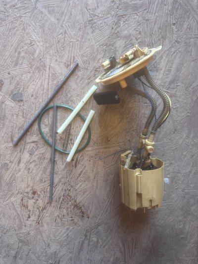

This thread is a few years old, but I just experienced this with my 2017 Ram 2500 Cummins with 55k miles. Fuel gauge would just drop to empty. I'd fill it up and it would only take maybe 10 gallons. Took it to the dealership and they found the fuel pump completely cracked/separated (see attached). Was in the shop for 2 days and cost $1,030 for parts, labor and gas to repair now in 2023 (no warranty coverage on it). The dealership said if I had let it go another week, I would have had to have the truck towed in. I reported this as a safety issue to the NHTSA at https://www.nhtsa.gov/ as @Joeram suggested. This should be a recall issue!
