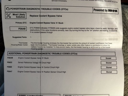

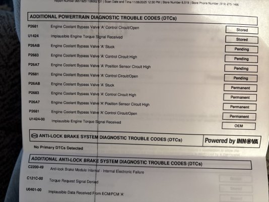

I’ve got numerous power train and ABS DTCs and CEL on my 14 Ram that I (and local shop) can’t figure out.
In September I replaced rockers and lifters on left bank of my 3.6 because of the ever present tick. This job went flawless and truck ran great with the only exception was when I went to reconnect negative battery cable. The bolt that clamps down terminal would tighten up nice but I could still wiggle the terminal off the battery post. I tried a lead battery post spacer from local auto parts store but it was too big so I used a sliver of it as a wedge. Not happy with that so I bought an aftermarket terminal off eBay. One that includes the battery sensor. Clamps on nice and tight.
Around 2 weeks after the above mentioned repair and battery terminal issue all hell broke loose. Multiple issues popped up:
1-CEL came on for P26AB which is the 3 way coolant valve stuck. This valve is only 2 years old and is a aftermarket one.
2-“service abs “ and “service electronic braking system” popped up on evic as well as abs, brake, and anti skid warning lights on dash. These lights come on at startup sometimes or once I put in gear and drive a few hundred feet or sometimes not at all.
3-“service electronic throttle control” has appeared probably 6 or 7 times too. About half of these times was while driving, goes into limp mode. Stooping the truck, Put in park, turn off truck, restart it usually clears this up. Other times it displays this message is at startup and it is obviously running very rough. This is very intermittent issue but most concerning for drivability.
Things I’ve tried:
1- unplugged connector to 3 way coolant valve in case it as causing short or some interference on same circuit.
2-rechecked all the connectors related to rocker replacement job.
3-checked 10 pin connector down stream from 3 way coolant valve connector for corrosion or loose pin.
4-started truck to wiggle harness(es) to get throttle message to pop up
5- disconnected several ground wires under hood to clean and reattach
6-had battery/charge system tested at local parts store. All good.
7-checked fuse panel to make sure all fuses are pushed in securely. About half did push in a hair
8- local mechanic had truck in the last few days trying to fix it. Tried replacing 3 way coolant valve but CEL came back and they said it’s “failing to respond and grounds the 5v ref”. Further stated “may have PCM or wiring issue. Recommend to dealership for repair”
See uploaded pics of codes scanned at Oreillys 2 weeks ago.
