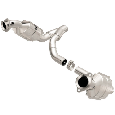

I am planning on installing shorty headers to solve (hopefully) the back manifold bold from breaking and ticking, its annoying. Also will install Corsa sport cat-back.
Question is... what to do about that middle section of Y-pipe and cat? Is there a better wye? The factory one looks like poo.

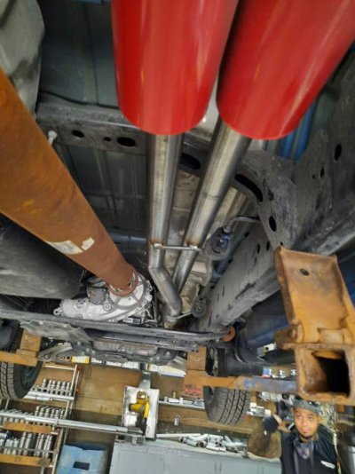

There is a better way, just depends if you know a good exhaust shop or not.
Or even better if you are handy with a welder do it yourself. But im picky about my exhaust welds and had it professionally done!
Had them connect the stainless 2.5 x pipe and single chamber totalflows to the stock duals in the rear and its amazing!!!
have some big tips waiting for funds and time to install and remove the stock rear resonators :favorites13:

Him we can help with your exhaust needs. For a y pipe for shorties I would recommend the Magnaflow. Flows much better than stock and still has cats so its legal
Another option since you are looking to replace everything is go with Long tubes for even more power gains. Message me if you would like more info or a quote on anything
