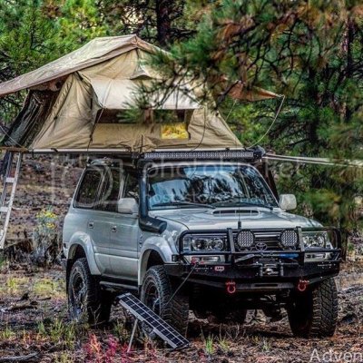

I'm after a Toyota Land Cruiser 80 Series. It offers 3rd row for the kids, reliable, and it's a new project I can tinker on same as the Dodge, only a little more daily driver friendly.
I'd prefer a FZJ80, which is the 93-97 that has the 4.5 rather than the 4.0, as it produces more power and parts are easier to find for it. I'd also, again, prefer a 95-97 for the interior comfort, along with air bags for obvious reasons.
Everything I'm finding around my area, they're all ranging from 5k to 10k and are usually somewhat a mess. Northern California has some really nice ones, but prices on those are ranging between 10k to 30k (no, not a typo).
For whatever reason, while browsing craigslist, they are all over the place in Los Angelos, most in better condition than those further north, and prices range from 2500 to 5k for 95-97's loaded with leather and under 200k on the odometer.
So, after we settle down from the holidays, I'm planning on taking a round trip on a plane, I'll spend a weekend down there looking at quite a few of them, then make an offer on the one I want and hopefully leave a deposit, if not might have to pay in full, then fly back. Following weekend, I'll load up the family in either the Tundra, or a different tow rig, we'll drive down to LA and pick it up, then do some California sight seeing while down there.
With picking one of these up, plans for the Ram will slightly differ now. I won't be AS focused on an expo vehicle. I'll still do the bed rack and probably a roof top tent, but I'm thinking I'll make the FJ80 a little more overlandish and keep the Ram on a trail rig level.
FJ80 being a DD, it'll stay a little more leveled back from the Ram, more so probably a 2.5" OME lift, 17's on 35's, ARB bumper and winch, snorkel, then I'll probably throw a Front Runner rack on top and for the most part call it's modifications good for the time being. Sometime a year or two down the road, I'll invest in a rear bumper with everything on it, but that takes my budget up a little more than I want to spend. I'll add accessories to the rack, but keep the vehicle modifications to a minimum.
One thing I love about the 80 Series, is they hold their value, and the value actually seems to go up with the aftermarket parts on it, unlike my Dodge. There's some fairly hammered, but built similar to how I want it, selling for 18-20k. Pricing out my stuff, I can keep it around 5k mark for upgrades, then always have the option of making about 50% back in the investment if I ever decided to part ways with it.

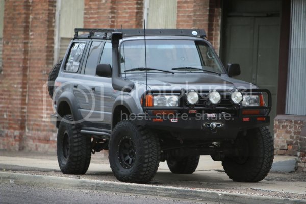

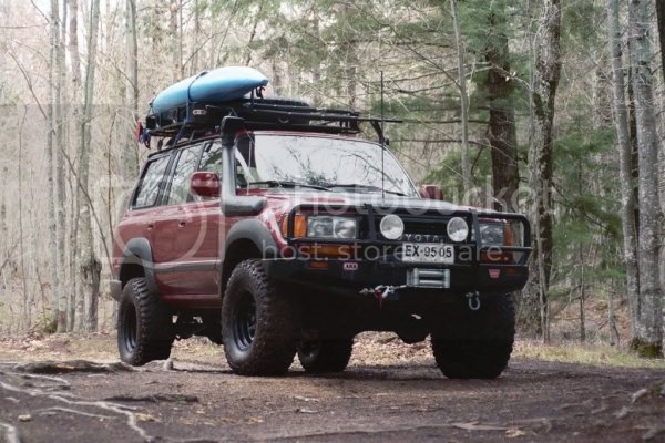

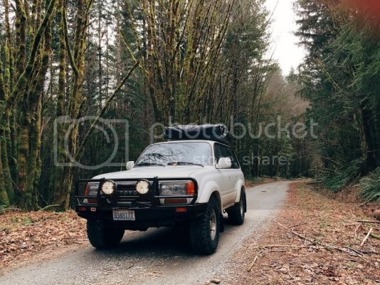

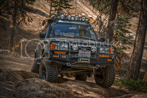

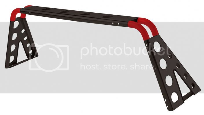

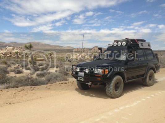

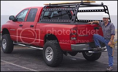

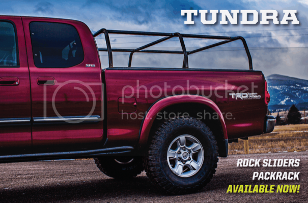

But here's some photo's that represent kind of the look I'm after with this project.
This one is more or less what I would want it to look like.

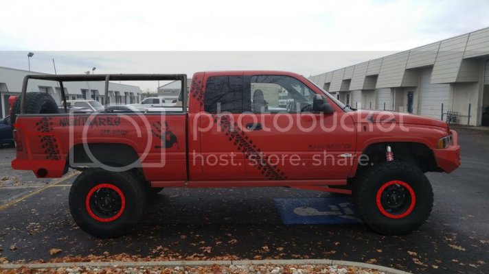

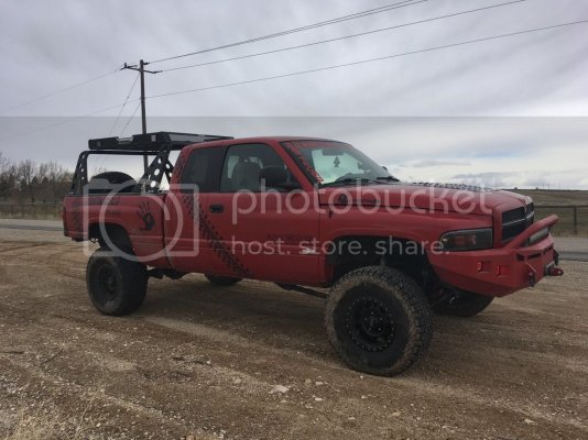

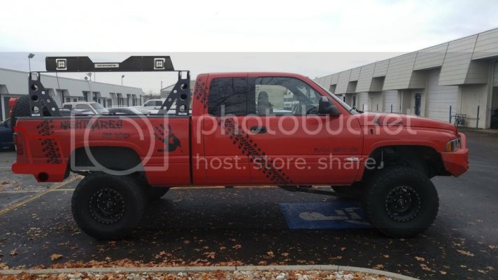

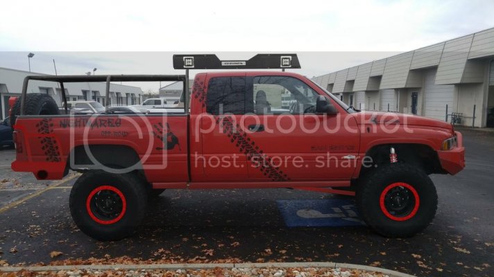

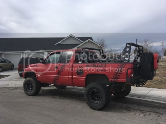

Did some photoshopping. Eventually the colors will change when the wrap is done, but due to time restraint, and the fact that my design still is not 100% complete, I'm going to wait until sometime late spring or maybe next fall to pursue the wrap further.
But here's kinda the outcome of what it should look like after this winter time when it makes it's debut at the Easter Jeep Safari.

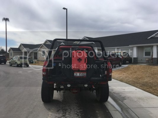

All items will be clamped down. More than likely this is how it will be for around town driving.

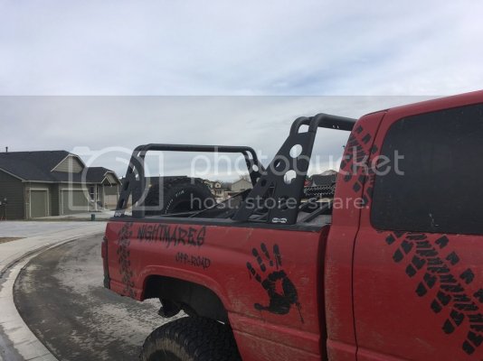

The rack I'm going to make removable as well, although I doubt I'll ever really take it off.

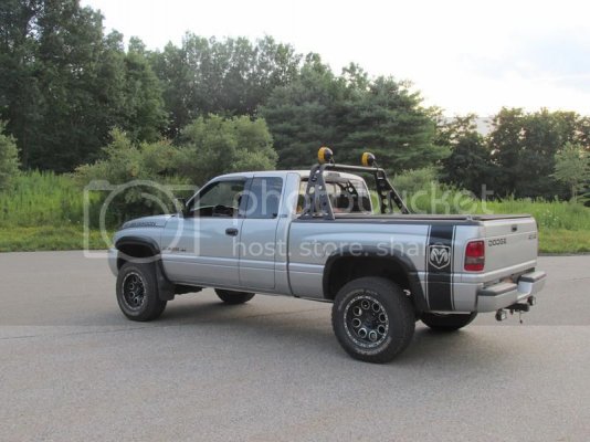

This is the final design for the overland aspect after my decision of getting an FJ80 was made. Rooftop tent and my one awning. Driver's side I'm going to make a ladder that connects to the horizontal tube on the rear bumper, then connects to the top of the bed rack, all bolt on so it's removable as well. Passenger side of the lower section of the bumper shows my exhaust exit, driver side will have a recessed step built into the side for a first step on the ladder in the same spot.
Ignore the flipped image. I'm lazy.
As for the overland aspect, I'm thinking I'll make the truck more of a gear hauler, and leave the actual sleeping and main camp site with the FJ. Something similar to one of these.
But that's another project for a different thread, but it at least explains the turn the Dodge is taking. The Dodge will have enough sleep space and storage for my family, the FJ I could bring along friends and people who don't have the means or the rig capable of coming along. Combine the two and I'd have a pretty decent overlanding setup.

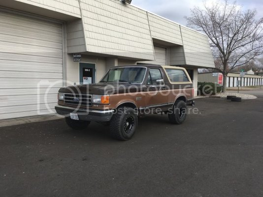

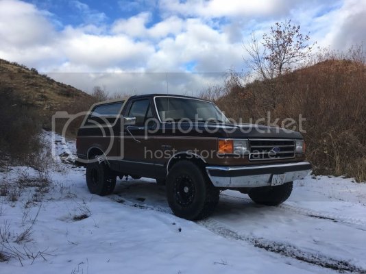

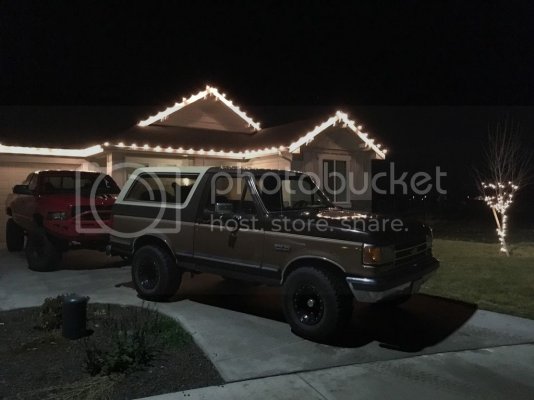

Dodge is GONE! Finally got the title to the Bronco so I started getting it ready to drive daily. Got some wheels and tires thrown on last Friday, so decided to drop the truck off to get the motor installed.
Due to it being a hook up from the builder, my truck is a fill in, meaning customer vehicles are first priority over mine. He's hoping to start on it this week, and hopefully have it all finished up by next Friday!
In the meantime, here's some enjoyable photo's of said Bronco.

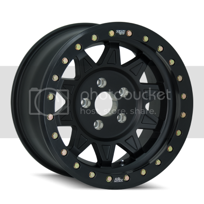

Alright, so it's been a while since I've had an actual update on the truck itself, so here it is.
After selling all Fox coilovers and shocks and other suspension items, the Hutchinson beadlocks and 37" Trepadors, as well as a few other items here and there for my other projects, I've finally placed the order for other goodies for the truck.
So, here's what's coming in. Should have plenty of time to get everything done before Moab!
980-02-018 Fox 2.0 Air Shocks (front)
980-02-241 Fox 2.5 Air Shocks (rear)
These will be used with my current suspension height and the truck will more than likely stay the height it is now for a while. I still have the Air Lift Autopilot V2 so I'll be able to control these shocks still, as well as my replacement front arms. Only thing I'll need is the rear lift addressed again, which I'll have a local spring company install a few 6" cut leafs to the bottom of the packs to eliminate the stacked block it currently has. Not sure if I mentioned this here, but a while back I sold my BDS shackle flip as I anticipated using the DOR, but that was sold with the suspension I just had.
Next
35x12.50x17 Nitto Ridge Grapplers
These I'll mount up on the Dirty Life 9302MB's I'm still waiting on to go into production. For those who don't remember what they look like, I'll throw a reminder picture in.

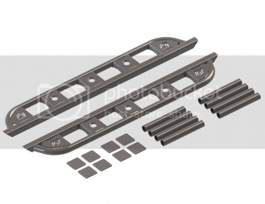

CU-59123 Chassis Unlimited Universal Rock Sliders

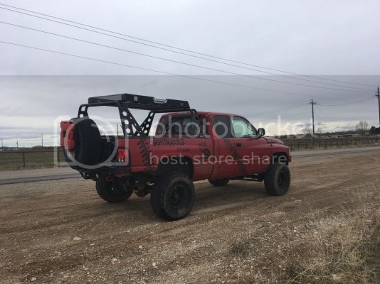

Scrapping the JK Rubicon sliders and just going to fab these up and call it good.
8206-AP-W-SB All Pro Off Road Pack Rack 00-06 Tundra Unwelded
To replace the rack I purchased for myself and then wound up selling to my buddy instead.

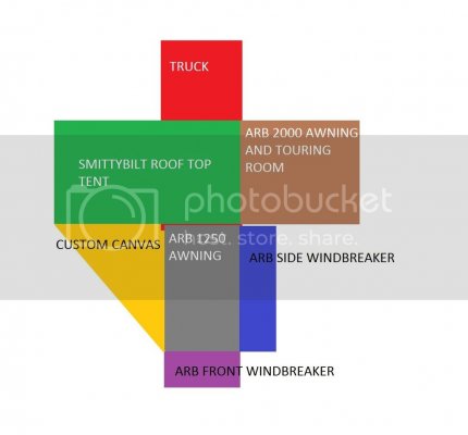

I also want to build a triangle that will attach to the Smittybilt Tent and the 1250 awning, giving a little coverage from rain or sun. I did a quick sketch in paint to show how I plan to have everything laid out to explain the corner triangle. It's labeled as "Custom Canvas" on the diagram.

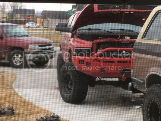

Still waiting on my beadlocks to get here. Getting stressed for time as in April I'm heading down to Moab for the EJS. I talked to them last week, and they were talking another 90-120 days for my 17x10's to be custom built, so I changed to order to the standard 17x9's with a lead time of around 30 days. Still getting worried, so I'm considering ordering the ATX Slabs sometime mid March. With those, if need to be, I can mount my tires on them and throw them on the Dodge for Moab. When I get back from that week long trip I'd hope the Cali's are there, then I can just dismount my tires off of the Slabs and move them to the Roadkill's, then mount up some new tires back on the Slabs and have them ready for the Bronco. I do have an update on tires though. I decided instead of doing the Ridge Grapplers on the Dodge, I cancelled shipment on them and instead ordered in the General Grabber X3 red letters in a 35x12.50x17.
Got a ton of projects going on all over the place. Getting prepped for the SAS on the Bronco which was going to happen last week, but ran into some issues with time from customer rigs and projects around the shop. So that'll be happening this week. Got my Mustang getting put together at the performance shop, so I've been in and out of that shop picking out and ordering parts, including having them revert the solid axle in the rear back to IRS and reworking the air bag sensors so I can put the stock steering wheel back on with functional air bags in case of an accident. Located some stock leather GT seats front and rear, so I have the rear seat out of the Cobra and the GT seats down at an upholstery shop getting recovered in charcoal leather with tan stitching (car is Arizona Beige) so it should turn out pretty sweet. All that I'll have left on the car is finding either a factory Cobra hood, or I've found a couple aftermarket that still have a sleek style rather than the bold 6" cowl hood it has now. Also picked up another vehicle. I had sold my Suburban a few months back to one of my employee's buddy's for his wife. They went to trade it in at a dealership on a brand new car, but they wouldn't take the burb due to a salvage title. So, after selling it to them for $2500 a few months back, I gave them trade in value of what a clean titled burban would have been to buy it back so they could go get their brand new car.
I've decided to finally do something with it, as it's a comfortable and reliable daily driver, but I obviously hate stock vehicles. So, I've got a 6" rough country lift, 20x10 Dirty Life Roadkills (same wheel as my beadlock, just street lock style) and some 35x12.50x20 Ridge Grapplers to go on it (the reason why I switched the Dodge to the X3's). That'll be a while, as it's a bottom priority vehicle right now.
But, I do finally have a good update for the Dodge. Hopefully next week I'll get started on building my All Pro Rack, so Friday I ordered in some red 31" Tred Pro's recovery ramps, and some additional steel and DOM tubing to add all my accessories to it. So, that's coming here SOON. But, this weekend I FINALLY broke down and did my retrofit on my headlights.

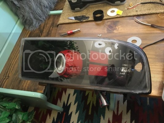

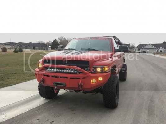

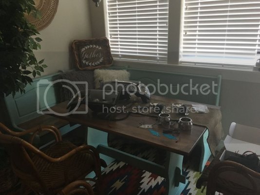

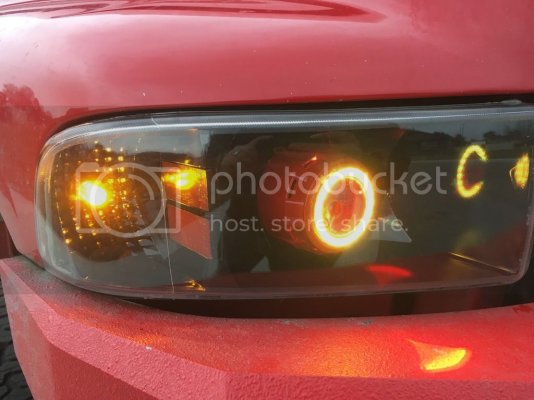

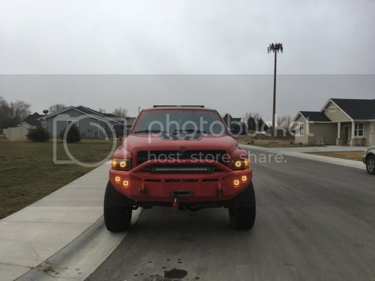

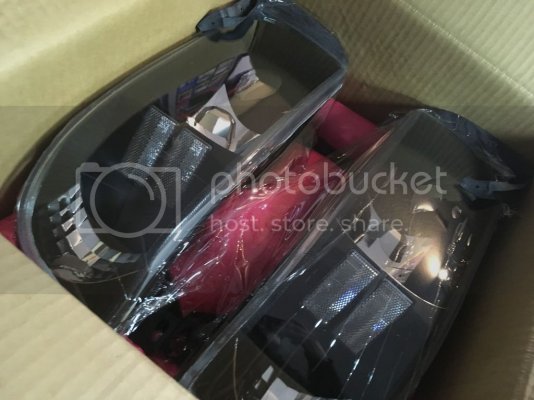

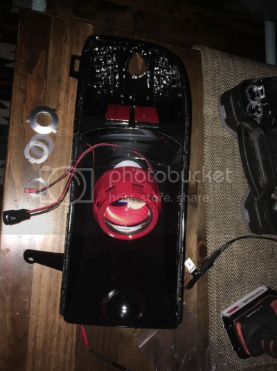

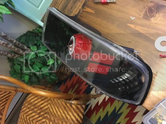

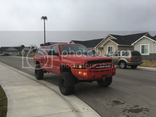

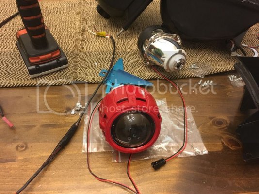

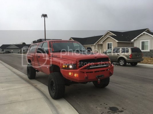

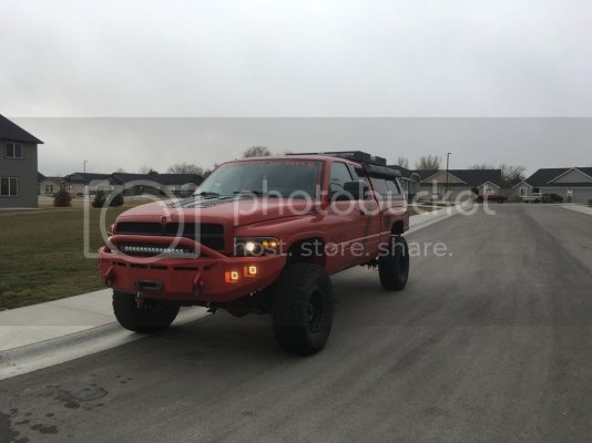

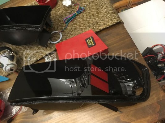

I donated my Winjet headlights I was going to use as I decided I wanted to go for a clean and simple look rather than overdone. So I started off with ordering some cheap black/grey one piece housings off eBay again, with no lights or anything else. And started tearing into them.
Fairly simple, but they turned out clean and I'm EXTREMELY satisfied with them. Painted the housings black, grey reflectors I did a light coat of red over the top of them (still reflect perfectly fine) and painted the shrouds red as well. From there, I added the Morimoto Mini H1 projectors, RGB halo's, demon eyes, then sealed them back up and wired everything in.
Again, very happy with the results. Only thing I have left to do is finish aiming them. I gotta pull the driver side headlight out and turn the projector slightly. Got them aimed height wise last night, and they're bright as all hell, but the driver side one somehow got slanted between aiming them on the truck, baking the lens back on, and then reinstalling them. Quick easy adjustment, and then they're 100% done!

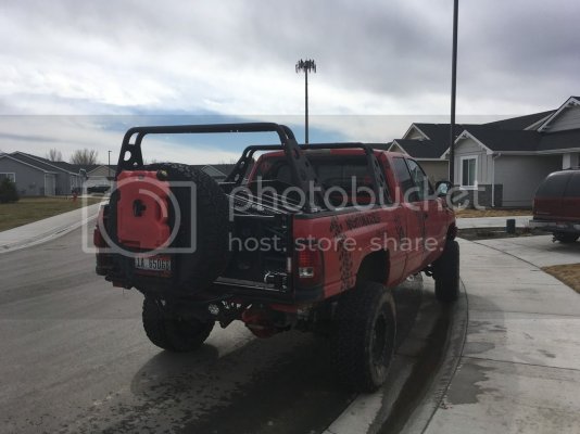

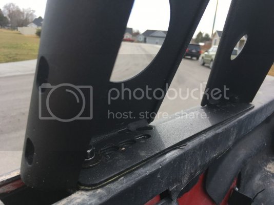

So, it's hard running a business and building a truck at the same time. Last week I was talking to a guy on a local facebook page that wanted to get into overlanding with his 04 Tundra. We got on the subject of my camper shell and roof basket, so he came into my shop and we started picking out a basket for him.
Then we got on the subject of me replacing my shell with a rack, which then turned into me showing him the rack on All Pro's website.
By the end of his visit, he walked out with my rack I bought for my truck, and I had $500 cash in my pocket.
Thinking nothing of it, I called All Pro to reorder the 3rd rack for my truck...come to find out the amazing awesome news. Backorder for 4 weeks.
So, I had to wait 4 weeks...to get a rack...that I had to fabricate once it got here anyways?
No. Wasn't gonna happen. So I set out on an online adventure to locate another rack. After a while, I came across what's called the Xtreme rack from Go Rhino..which happens to be the same manufacturer of my roof basket. I went nuts trying to find it, only to find out...it's been discontinued.
Here's what it looks like.
What clicked in my head next was the fact that it's the same style as Go Rhino's Lightning Rack, which is the same roll bar/light mount I was considering a while back.
Gears started turning, and I decided to do a photoshop of it. Photoshop looks like **** thanks to angles, but you get the idea.
After spending more and more time looking for a rack, I decided to pull the trigger on the Lightning Bar's instead. My issue was the fact that they don't make them for a 2nd gen, only 3rd gen and up. I found pictures of a 2nd gen with one, more research resulted they used the 3rd gen setup and I hated the fact that it stuck up over the cab.
So I measured a 3rd gen from a neighbor in our complex, and discovered the cab height from the top of the bed is 23" high. My 2nd gen is 21" high. So, I started browsing more and more and found they make it for the 99-06 GM truck's, which one of my employee's owns. So we measured his, 21" high. I got the bed dimensions for camper shells off google, found out it's identical in width and length. Looked up the part numbers on a distributor's website, even more luck. 2 in stock in my local Portland warehouse.
So, I ordered them yesterday. Delivery will take place tomorrow.
Then, I started looking at it closer, getting all excited. And found for some reason the tubes are a different shade than the uprights and crossbar.
So, again, a little photochopping, and here's the final outcome.
I'm starting off with just getting the rack mounted across the top. Just going to get some strips of 3/16, mount it to the bottom of the rack and to the top of the lightning bars, and call it good for a while. I'll start adding to it as I find where and how I want to mount everything. But, for now, the shell's getting removed and I'm finally getting my rack.

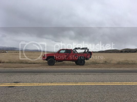

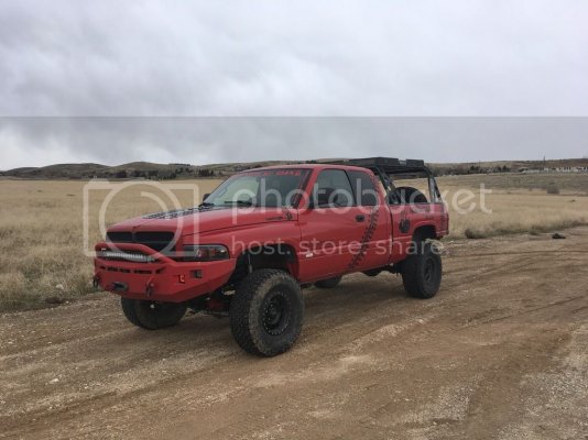

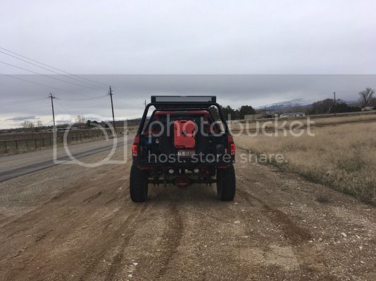

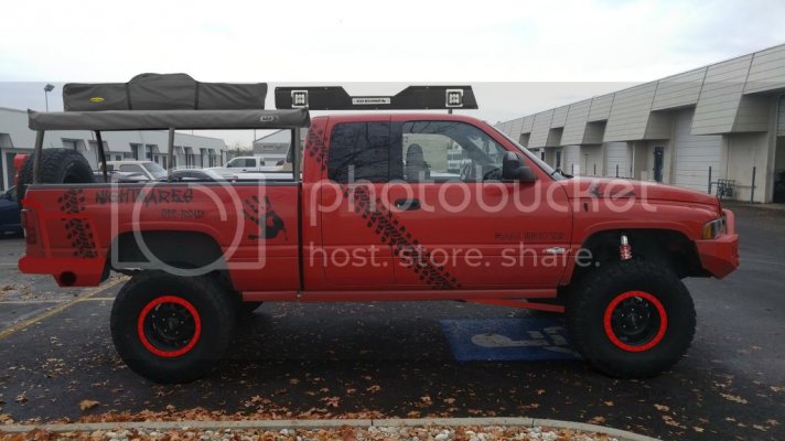

So I got the bed rack started over the weekend. Today I'm going to try to remount the basket, the rails I have are currently mounted to the top of the Lightning Rack's, and I wanna switch them so they come down underneath to lower the basket and inch and a half. Just need to find some square tube scrap lying around to use as a spacer between the top of the rack and the bottom.
But, it's on, it's sturdy, and it looks decent for right now. I'll update again later once i get the rack lowered and the racks positioned correctly. Here's some process photo's for now
I've also found a way to temporarily mount my awning until I can figure something else out. In the meantime, I don't want to drill any more non-necessary holes, so I'm going to utilize a hole in the crossover of the racks. There's a third hole in the middle that I'm assuming is for some small lights for side lighting or something. My awning has a slide channel for the bolts to slide into, making them adjustable length wise for any and all mounting adjustments. For now, I'm going to get some longer bolts, slide them into the channel, then bolt it on using the hole already there. This will get it mounted to the truck, but still be removable for the future when I figure something else out. At least with it there, I can still take the truck out on trips and have it functional.
