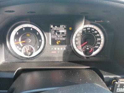

Well, reviving this one unfortunately... After 6 months/7k miles of having no issues, I pulled my Superchips and installed a Diablo. First turn of the ignition and the gas light came on and after a few key cycles the cel is back.
Coincidence? I'll report back once I figure out the culprit.

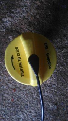

I just ordered one last week and I did not get what I ordered. After a year, the vaseline trick is no longer working. Went ahead and put this new one on and still have the gas lights and cel. Anyway, instead of getting what I ordered in the first pic, the second pic is what those ding dongs sent me. It actually says E85 Gasoline on it. Lol..

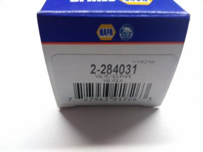

Bought a new purge valve from Napa. So far, about 100 miles and all good. I think I am fixed!
This all started a year ago, about 85k miles .Now have 100k. Was commonly throwing codes po441 and po457 in combination.
Purge valve purchased:
Echlin Canister Purge Valve
Napa part# CRB 2284031

PSSS: Get rid of the E85 cap and put on OEM one???

Yeah, I never ended up putting that cap on and got the right one, lol... I might just remove the catch can, clear the codes and run a tank of gas and see if the cel comes back. If not, I will reinstall the can, tape the thread on the dipstick and do an upgrade on my hose connections. I think the rubber hose is fine, it was the fact that I inserted the hoses into the existing elbows rather than purchasing larger barb fittings. They fit in perfect to the elbows and do not leak fluid but they may not necessarily be 100% airtight.
