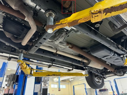

I'm updating this post as in spite of how rust free /clean mine is underneath it needs the gas tank front strap mount replaced or Repaired.
I would encourage ALL to check their mounts regardless of where you live. The design they used is extremely poor at best and traps debris / dirt which when wet stays that way for awhile due to being almost completely enclosed.
I would also strongly encourage drilling drain holes as others have suggested or possibly opening the bottom of the mount up completely. Failure to do so will eventually rot the frame itself.
For anyone needing the info on the 12 year extended warranty
12 YEAR tank mount WARRANTY
May have to turn of your ad blocker and dig around a bit but the bulletin should be there without downloading anything else.
I'm debating on doing it myself or letting the dealership monkeys Screw it up :shakehead::Stupid Me:
:cheers:RAM LINCOLN.jpg

It’s the Front-strap mounting-bracket …….on SOME trucks….and that pic has (apparently been re-purposed from one red-highlighting the frame dampeners…not the front tank strap Mounting-Bracket.)
The recall doesn’t say it, but I suspect a combination of untreated / incompatible or inappropriate alloy or treatment was used to assemble that bracket. I’m guessing, of course.
I saw this recall on my 2012 Ram 1500 and it was always just fine. Same on my present 2015.
Here’s the notice:

(It’s the ones that …“experience a noise coming from the Fuel Tank area or a state inspection technician stated the front fuel tank strap is detached or the strap mounting bracket is excessively corroded.”)
