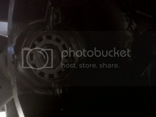

the adjuster nuts are adjusted with a tool through the end of the axle tubes, i had seen somwhere that people were welding a large nut to a pipe to make a adjuster tool....

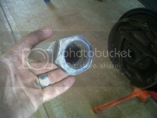

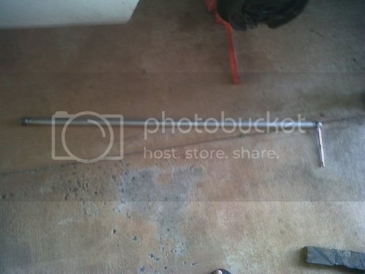

the adjuster tool:
1.5" ball receiver nut (lightly ground down)
1" emt
3/4" socket
welded together:
