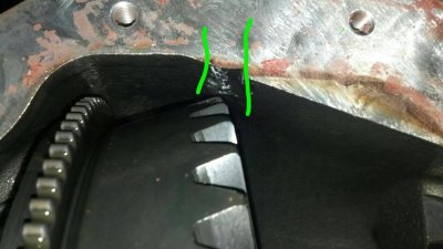

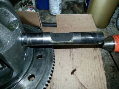

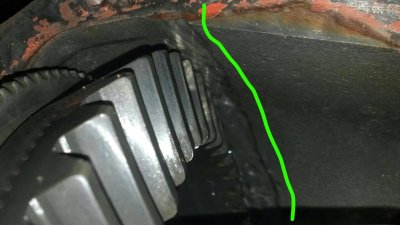

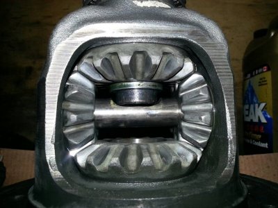

You have to modify the pin so that you can install the axles and insert the c clips once the pinion is torqued to the carrier and you also have to modify the axle housing itself to fit the ring gear as it is larger than the hole its supposed to fit in. As far as tools, not much specialty stuff is required other than a dial indicator with a magnetic base, inch pound torque wrench with a dial for rotational torque and of course the tool to set your backlash and carrier bearing preload. You can build the adjusting tool yourself if you have access to a welder. Some people made it out to be rocket science to rebuild a chrysler 9.25 when i had a few questions but if you have some knowledge of how to set up a ring and pinion then youll be fine.

I have the Auburn and 4.56's. NO mod of the carrier necessary with that set up in an 03 diff. I do everything myself, except for the gears I paid the Gearcenter to do it, the guy had 18 years experience and with that it took 5.5 hours to do the rear. As I see it you are planning on re-gearing an OEM LSD, I wish you luck (not in a sarcastic way) just take your time and I bet you you will swear just trying to remove the pinion nut!
