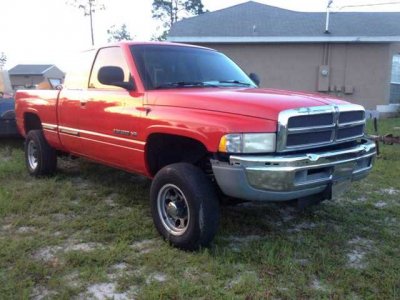

It an Automatic....was looking for a manual but great deal on this one. ImageUploadedByTapatalk1408664828.198872.jpgImageUploadedByTapatalk1408664880.559695.jpg
