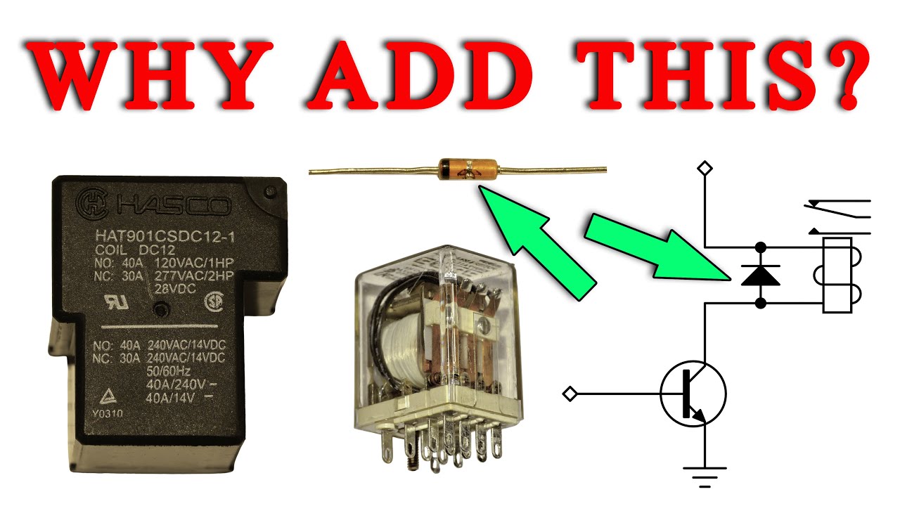

Good video on why and howto add a diode to a relay

I still add a diode to any relay that's going to be turned on and off lots. I've been doing this since the late 80's,and have never had to replace a relay since then.

It is really interesting to see the "voltage spike" that happens when a relay opens. Some weird stuff, speaking of the 80's, some of that weird stuff was clocks changing time when the power seat was operated.
