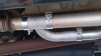

My truck has a 14" Magnaflow and no resonator. 3" single exhaust. On the expressway, the drone was driving me nuts. I just installed the "DODJP" drone suppression pipe from Mufflex this morning. Install was super easy. It took all of 20 minutes. 2 quick sawzall cuts, then just slip it in. It fits the truck like a glove. I cranked the included band clamps tight. Then started the truck. Let it warm up. Then tightened them a little more. Zero leaks, and I elected not use hi temp silicone (but, it's recommended per the instructions). Driveshaft clearance had plenty of room. Didn't need to bend the shield as some have experienced.
Anyways, I just took it around town to run some errands and the drone is COMPLETELY gone! I have no idea how this thing works, but it does. It was a bit expensive though... came to like $200 with shipping. I'm sure a competent custom muffler shop could make one for cheaper.
https://www.mufflex-performance.com/dodge-ram-1500-2009-up-to-2018/97-j-pipe-noise-eliminator.html
*Note, it's not hanging down or anything. It just looks that way in the picture because I crawled back under the truck, after I lowered it down and had to hold my phone at a goofy angle. :)

Do you know if this product will work with non Mufflex (ie Maganflow) mufflers? I have a bit of drone that I'd like to get cleared up and wonder if this thing will work.
Could you take another picture showing the whole unit?

J pipes should work with just about any exhaust system that has drone. They work by helping to tune out resonance which is where the drone comes from.
Mine is not a "Mufflex" either. It is a 14" Magnaflow that my buddy welded in for me. That's pretty much the best picture I can get, without jacking the truck up again.
Here are the installation instructions. You can clearly see what it looks like installed: https://www.mufflex-performance.com/PDF/guides/DODJP_Installation_Diagram.pdf

Well, got the Mufflex j pipe installed. It really makes a difference on interior sound levels. I would say it cut my in cab volume down about half (not talking about drone, just the amount of exhaust noise I can hear). Where I notice it most is when the truck down shifts coming to a stop.....can barely hear that now. Highway speeds are super quiet (maybe stock like). I still have a little drone in the 1600-1800 rpm range, but I'm still adjusting the j pipe. Idle volume seems to be slightly lower too.
I don't have access to a lift or a lot of tools so I had my favorite muffle shop install. They inserted the j pipe piece about halfway and clamped it. Still had about the same amount of drone at this position. When I got home, I loosed the clamp and pushed (I mean lightly hammered) the pipe in about 2 inches. Not sure if it's all the way in just yet, but so far this setting is better. I still have a little drone, but I would say it's cut in half to what it was......and it wasn't all that bad to begin with. It's definitely livable. I will drive around for a few days and maybe make another adjustment if needed. All those using this j pipe, how far in do you have the pipe inserted?

I put mine in all the way. The instructions say to initially start out with it all the way in, then adjust out 1" at a time, if needed. I was satisfied with the results, so I just left it alone.
Thanks. I will most likely check this evening if mine is all the way in. I guess it will stop moving once it's all the way in? It's a very tight fit, so I have to lightly hammer to get the pipe to move.....don't want to over do it.

Yes. it will stop moving. I'd recommend using a block of wood between the hammer and pipe, rather than beating on the pipe directly. Don't want to dent it. :)

Yep, I was using a block. Didn't have to whale on it....just semi light whacks to get it to move. It's tight enough that I can't move it by hand.
Did you notice your exhaust volume in the cab to be considerably lower with the j pipe....not just the drone? I was surprised at the difference.

Yes. Inside is definitely quieter when cruising at speed. But when you stomp on it, it comes alive. There's this large bridge that I have to go under every day on my way home from work, kind of like a tunnel. When I go through there, I just HAVE to hit the gas. It sounds like an 800hp beast in there. LOL
