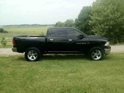

I just got 295/60R20's yesterday. Had to get a 1/4" spacer but nothing else. It still rubs just enough at full lock to shine up the upper control arm but other than that 295/60R20 is a pretty good fit. Basically a 35 without the 12.5 width

I'm in love with em. Had to go down and get our old stands we used to put our deer blinds on from the farm and the gumbo wasnt really too bad except for some spots here and there and they easily just went right through in 2WD with maybe 4000 lbs on the back. And they're a lot more aggressive in person than what you can get from a picture. Did have to put a 1/4" spacer in but so far I haven't had any trouble. They ride rougher but theyre a mud tire so that's to be expected. And they do have a howl but not much of one. I like a little howl personally but, anywho. Here's a picture I tool today after cleaning it up from the farm. You let gumbo stay on tires is turns em blue for some reason? LolImageUploadedByTapatalk1369706209.463950.jpg
