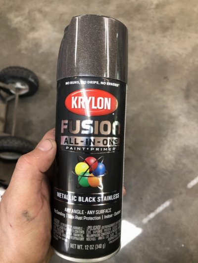

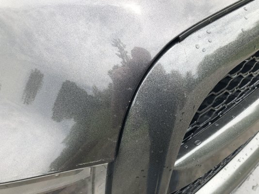

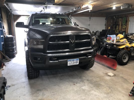

If anyone is interested in color matching their granite Chrystal Metallic truck's and don't want to pay a premium for Mopar paint or doesn't have a local place that can make it I found a great option. It's 99% perfect match. And if you spray it just right it would be a 99.5% perfect match.
Use this and a 2k clear gloss clear coat
I did my bumpers and grill with this
2018 2500 6.4L Hemi Tradesman
Awsome find!!!
I've searched and this is as close as I could find although the metallic doesnt seem as much as oem!

Depending on how you spray it, to close and the metallic is fine, to far away the metallic is bigger, somewhere in the middle is real close to the size as oem.

that's awesome man!! what prep did you do for the bumpers? I assume they were chrome?

Sanded them with 60 grit on a orbital sander (sounds like it would leave scratches but it roughs the chrome up just enough). Primed with self etching primer, used flat black as a base coat. Then paint and clear. I took about 3 day's to complete. Day 1- sand and prime, day 2- base and color, Day 3- clear.

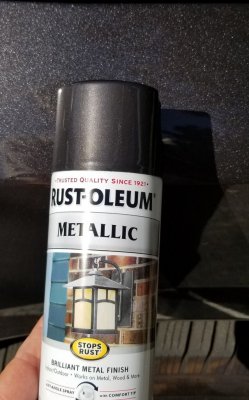

They clear is the most expensive part. I tried with some rustoleum clear which was OK. I ended up using this
USC SprayMax 2K Glamour High... https://www.amazon.com/dp/B0082LJMC6?ref=ppx_pop_mob_ap_share
3 coats (1 can for the grill and about 1.5 cans per bumper) gives it that oem gloss look and feel.

looks great, did you start with chrome grill and bumper ?
