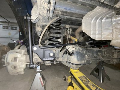

Trucks is slowly coming along. My slow progress is a combination of my lack of talent and time time spent catching up with the family.
Rear end is done, I’ll get the front end finished up on Monday.

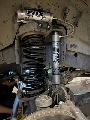

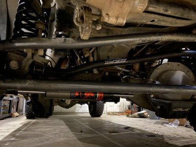

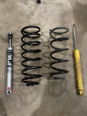

Got the front end done today. 1.5” Thuren springs, Thuren trac bar, Fox 2.0w/resi, boogie bumps, and fox ATS steering dampener.
Two sets of hands made the project a breeze.
Truck still fits in my garage...barely!
Test drive was good, truck rode nice and smooth. Now time to schedule an alignment.

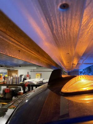

you have a 7 foot garage door? Hell mine is close now with 35's and no level.
well as long as you have a few inches to spare you should be good. Thats all a level and 37s is gonna add.

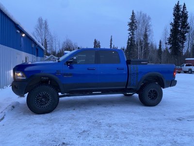

It’s a 7 foot door. I measured the clearance before hand to make sure. I’m just glad the KM3s run a little on the small side lol. Up here in Alaska I wanted to be able to still park in my garage.

my thuren lift brings me to 7 foot with my 37 RT toyos.
remember, some of those drive-through and parking garage signs are lying to you about 7 foot.
(i clipped a low hanging sprinkler and it scuffed up my roof in a 7 foot garage)

increased hot tire pressure, featherweight female driver, no tools/load and an empty gas tank and i bet im 7 foot 1 inch

Parking garages are most likey the posted height in most cases, but they also have angled floors which can really throw off the overall height, especially when factoring in a long wheelbase vehicle.
A personal garage would be pretty easy to figure out...but, I dont think I would be testing 7’ parking garages with my wagon. You have balls of steel LOL
