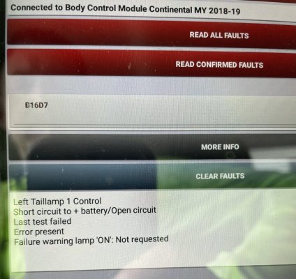

I know there are a bunch of threads but they seem to be with LEDs or aftermarket housings so I’ll take the brunt of asking this. Every light is working even 3rd brake light. I have OEM housings and halogen lights i do have reverse LED canbus error free. Could the bulb still be bad or is it likely the socket? I find it strange I can put 3” cluster back in and don’t get the message.

When I turn the lights on and I look at the lights they are all on, with the exception of course the 3rd light since that’s never on until brakes are touched but the parking lights are lit, the brake lights light up when brakes touched, blinkers front and rear working. I did just start getting this after swapping to a 7” cluster from the 3”. And I never had a Uconnect headunit if that matters.

All the exterior lighting works correctly except AlfaOBD is showing a L tail lamp wiring fault. Yes or something else?
Yes, only after it pops up on EVICE

I have to wonder if the 3" is incapable of producing the same fault as the 7" EVIC. I trust that you have thoroughly inspected all of the connections on the EVIC, correct?
My money is on the possibility that there truly is some degradation to the wiring, connectors, bulb socket and/or ground associated with the L tail lamp.
I would re-install the 7" EVIC, confirm that the 'bulb out' fault returns, and inspect the L lamp socket wiring for damage and the socket for corrosion.
Next, inspect the ground connection for that lamp. Is the ground connection tight, corrosion-free, and no damaged wiring?
If you have a multimeter, remove the bulb and have a volunteer step on the brake while you measure and record the voltage between a good ground and the center connection in the socket. This is to prove the 12 VDC feed to the lamp.
Replace the bulb and then measure between that same ground and the outside of the lamp socket, it should be 0. If you are able to measure any voltage, even in the mV rage, this suggests that the ground is compromised. The BCM monitoring may be more picky than what is required to illuminate the bulb. AFAIK, the BCM generates the bulb out fault notification on the EVIC.
Unless the ground connection point is clean and bare, it might be worth removing the ground screw and scuffing up the surface with emery paper, applying a very thin film of dielectric grease and re-assemble.
Then, check to see that the 'bulb out' fault has cleared.

Issue was the socket. Figure I would update, it's been about a week now and I have not had parking light out message since replacing the socket. I bought OEM from dealership, $18. I can also confirm, i would get this message within 30 seconds of lights being on, and every time i pressed the brake pedal.
