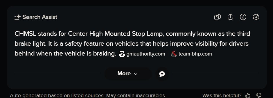

Baptism by fire!
Yes, I know. Many new people who visit here haven't yet figured out how to use a search engine. That's unfortunate, as the introduction of AI integration has made it much easier to resolve than it once was.
