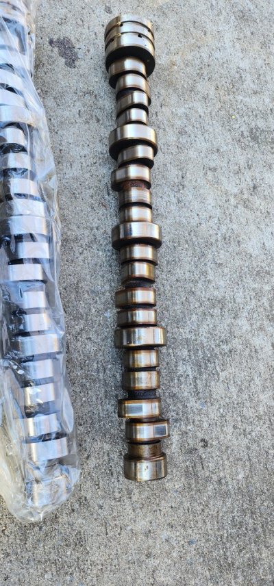

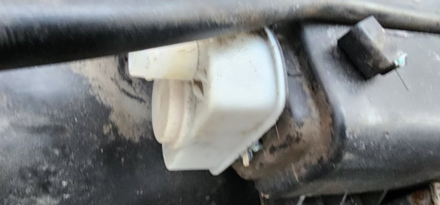

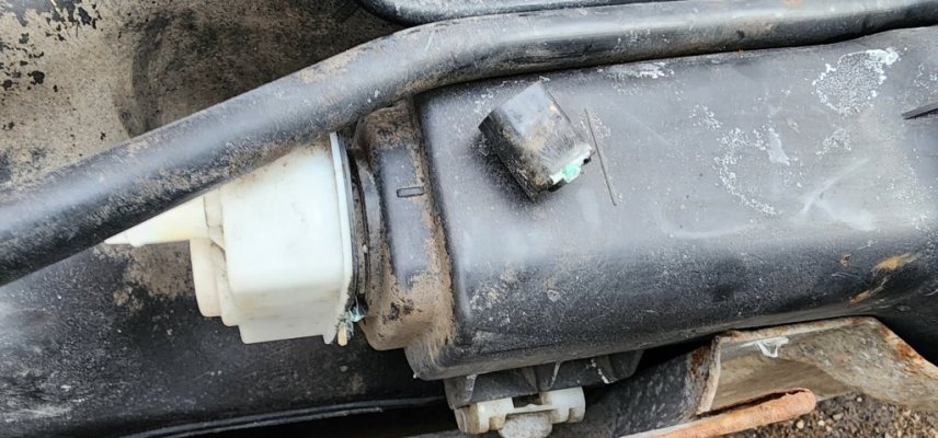

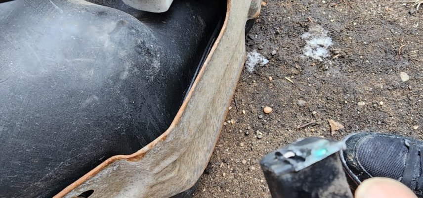

I was dealing with smae issue finally point to freaking issue after long testing and changing handfull parts
2014 ram 1500 5.7
Cranks looong time hard to start unstable idle hig fuel pressure codes
It was the freaking charcoal canister
Got used tank from local junk yard replaced canister starts right up no codes and i had to change cam for po300
I hope this helps some
Canister is located top of gas tanks on the lift easy to locate electrical connector cracked causing the shorts
