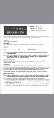

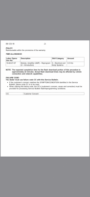

I am a new RAM owner and appreciate the information in this thread. I have been trouble shooting the music system and plan to get the dealer to perform the service as outlined by Siff. I am surprised that there is a problem with the sound system since they had it "voiced" by a Nashville music producer. I expected it to be pretty good.
I thought I would share my observations in case they could be helpful to someone. My main problem is with the bass, it is too "boomy" or "muddy". I have the equalizer at Bass= -4, Mid= 0, Treble= -2. I suspect that the cross over between the large door speakers and the subwoofer has too much overlap in frequency.
I initially had a problem with the volume being too low when I played music from my iPhone 6 via bluetooth. Most of the other bluetooth devices that I have control the volume of the phone. This is not the case with the HK system. Once I manually increased the volume on my phone, the HK volume was plenty loud.
I am playing uncompressed WAV files [1411 kbps] that I ripped from the original cd. I observed sound quality to vary by input method: iPhone 6 bluetooth was the worse, WAV files on iPhone connected via USB B was in the middle and files on a usb thumb drive or hard drive connected via usb c was the best.
The HK system would not recognize my iPod classics [I tried 2 different ones- they work fine in my other cars].
I found that the HK system will also play FLAC files but not AIFF files. I was also surprised to find that the system will play high resolution WAV and FLAC files [24/96, 4608 kbps]. I have no way to tell if these high res files are down sampled but they sound pretty good.
I hope this is helpful. I will post again after the dealer service.
