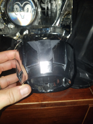

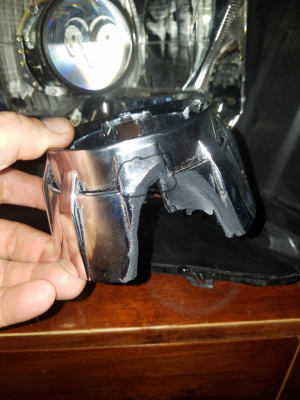

These are Gatling Gun 1.0's that I trimmed for my Mini D2S light build. They're pretty large for the low beam reflector. I'm ordering another set of these to "clean up" my build. The first picture is the top of the shroud where I used a 6inch 80grit sanding disc on a disc/belt sander combo and the second picture is the bottom of the shroud. I took too much off the forward part of the shroud where I "circled". I don't know how much the Panamera you want to show, but it looks like you might loose some of the middle between the little "windows" along the outside that would work.
I don't know if this helps you out, but this is what I did.

Thanks but i have a ton of experienced cutting other shrouds for the quads, heres a pair of Apollo 3.0 shrouds i cut to fit the low beam spot of the quads.
My question is specifically for the Panamera 2.0 shrouds pictured in the first post. Thanks for your reply, if i had never done a retrofit before your reply would have been very helpful. Thanks.

OK, I didn't see the LED ring in there....my bad. Yeah, I got nothing...thanks for the reply on the other thread. I'm getting another set of Gatlings to work on. I just call this my practice set.
