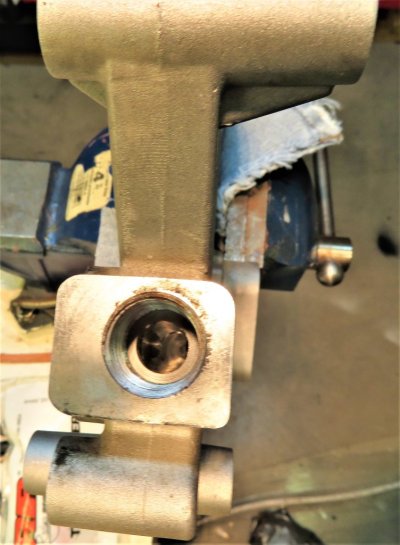

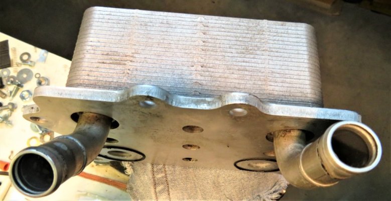

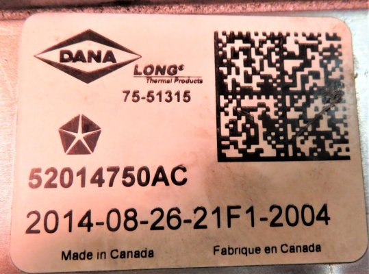

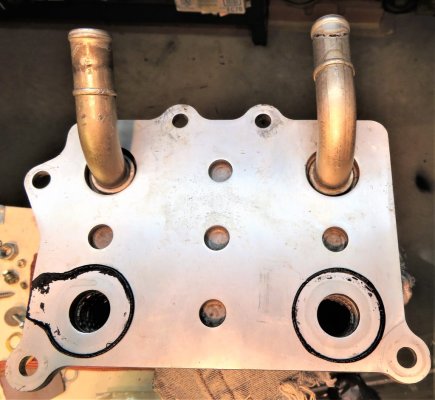

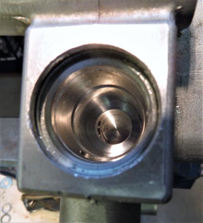

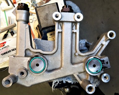

Have you been under it,to see if it has the thermal heater like the 1500's Dean. I didn't think the Jeeps had it,but i've never actually been under one to look. If they don't,you can buy bypass units for the cars,and i'm guessing also for the Jeeps,but they're a bit differant then Jesse's bypass is,as the thermostat will be in the cooler lines.
This is what the trucks heater looks like.
