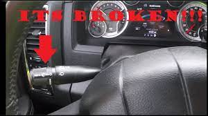

hazard lights, windshield wipers, turn signals, Hi/Lo Beam Headlights & maybe other things are controlled by the Multi-Function Switch on the left side of your steering column,, watch a YouTube Video or 2
Easy replacement, if that is the issue
