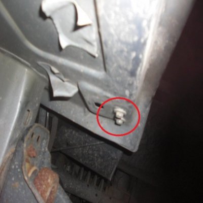

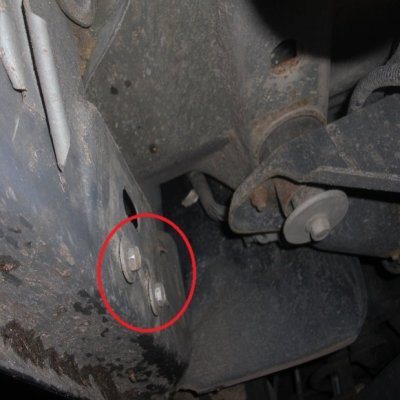

TEXAS
Nov 5, 2012
142
2009
Lookin' good, congrats. Now I have to check and see how my OEM bars mount to see if I'll have any issues.
i just went out to take a look under my truck. i tried to take some pics (although it´s getting dark already:)).
the pics show the rocker panel on the driverside. i took of my steps for the winter but left in the screws (the grey ones i a red circle u see:)).
for me, the steps are mounted directly to the body so that there shouldn´t be any problem at all.
or do i get something wrong??? pls tell me what u think:)

Cruizer
Sep 16, 2013
6,816
2,427
Ohio
2010 Sport 4x4 QC
Those all look to be in the body to me. I'll have to look over mine, but I'll be waiting until the snow melts, lol.
