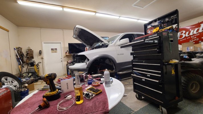

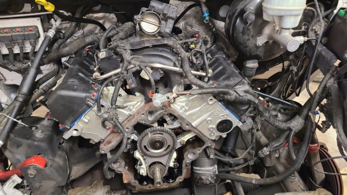

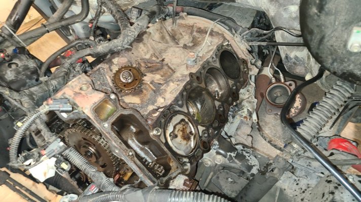

Progress.

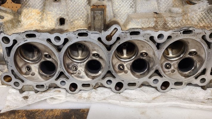

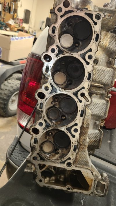

Heads are off. 1 and 3 were leaking into/from the water jacket.
Heads check out square with a straight edge. A couple seats on the valves look suspect. More to do there to make sure they are good.
Will open that can of worms tomorrow...

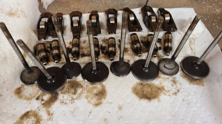

Seats check out fine. Look almost new.
Exhaust Valves on aren't shiny smooth like the intake valves are. Smooth but not shiny smooth a little pitting..
Will drop both heads off tomorrow to get worked at the machine shop.

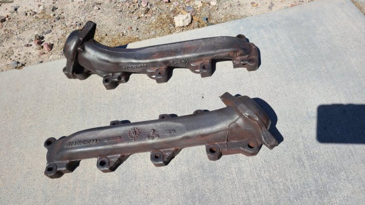

Exhaust manifolds cleaned and painted with fireproof header paint.
New rebuilt heads will be here tomorrow. New bolts all around already here with the gasket sets. Hopefully re-assembly this weekend.
