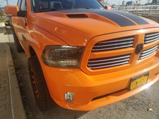

Ok this may be a stupid question but how the hell do I get to my pass side headlight bulb to replace it...2015 1500 sport projectors???
And what bulb do I need also would be helpful ?
I can't be this stupid lol but I can't seem to figure it out ...help!!

I forget the bulb #, but there are a few screws you have to undo on the top of the headlamp assembly, should be readily visible. After that, look up in the wheel liner behind the headlamp, there is an access panel. Open it up and feel around for a clip. You have to disengage it. Then you can pull out the whole headlamp.

It’s easy as hell.
1. Pop the hood
2.take the plastic cover off the top of the grill.
3.Unscrew the four 10mm bolts on the grill.
4. Remove the grill there are 4 connections that pop out.
5. Pull the flaps under the wheel wells out. They are attached by reusable plastic pop in pieces.
6. Reach into the wheel well flap you just opened and have to look for the white guillotine style clip and push it up on both sides.
7. 10mm black screw on the top part of the headlight
8. 10mm silver screw on the bottom part of the headlight
9. Pull the light out
10. Pull the electrical harness out.
11. There are four 8mm bolts on the back of your headlight (screws on TYC replicas) remove all four and you have access to the low and high beam bulbs.
12. Put it all back together and don’t forget to pull that guillotine style clip down in the wheel wells! (I’ve done it before)
