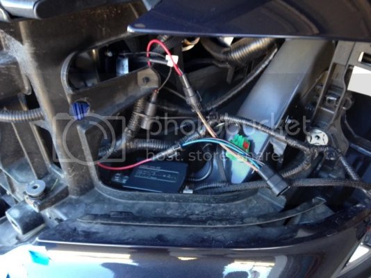

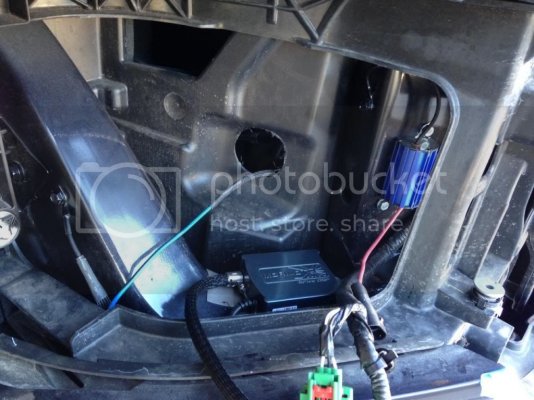

Where is everyone mounting their caps, relays, ballasts. Etc? Any photos?

No pictures, but the ballast can be mounted inside the headlight housing (shoving it in there) or there is a frame part coming down at an angle. Relay you would want somplace visible (drill a small hole in the fuse box holder (not the actual fuse box, you will see there is room to fit fingers on both sides of the plastic). I found it held with a zip tie and velcro. Resitors need to be mounted to metal away from plastic/wiring (those are probably the hardest to find room for). Grounds, JJ suggests to make your own (sand down paint and use a screw). Capacitor doesn't really get mounted (just grounded). Goodluck with install if you are in the process! But like mentioned above, you mount where you want, find room and make sure relay harness is long enough for everything!

I also did what Exhausted did. Ballasts mounted on the steel, I just used 3M tape.
I have the relay mounted on the drivers side, just below that odd rubber dampener, mounted to a factory bolt for something or another.
