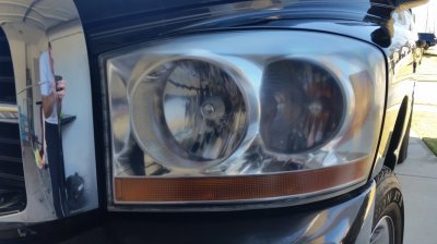

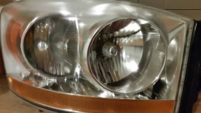

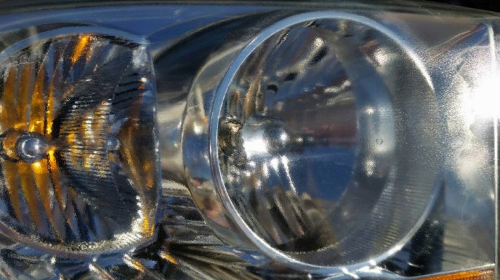

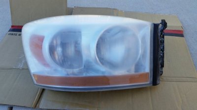

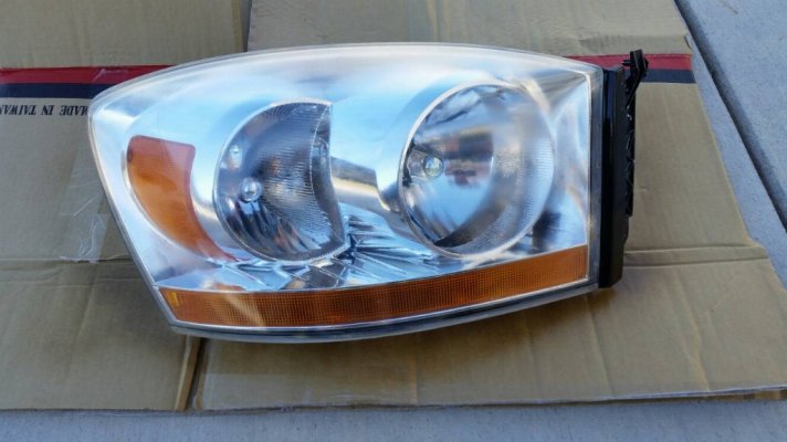

Started the process. Put the 08s on my truck for the mean time. Here's a few before and afters.6a5b7741747565e68c4e2cfec6be681e.jpg783b13c068656874766aaeb812853972.jpge0a7110e373440298de0dc6ddd6f37c9.jpg
Looks way better!

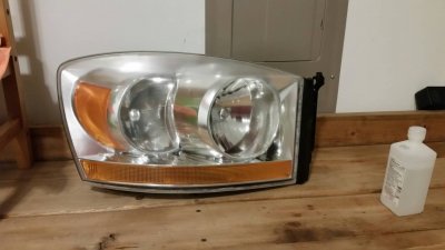

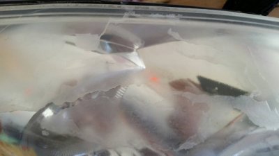

Here's a few before and during the process.
fbebbcc9be7efaec1c9401ea7751b40a.jpg20170226_152016.jpg52252385448095eea180a3950a3471da.jpg
After sanding
After one coat of clear
More to come!!

Close up
It's a little rough. Go easy on me lol. It's my first time ever using clear coat. It's got a few straight lines in it that are bubbled up. Might have not let the second coat dry enough. Going to wet sand with 2000 again tomorrow after it's cured a day and see what happens.
At any rate, it's better than what it started as lol...

You didn't sand them enough. In the picture before you cleared them, you can see the lines where you removed the UV coating in some places, but not in others. You have to remove all of it and it should look perfectly even and flat before you do anything else.

Thanks. I'll give it a go tomorrow. Only our three light coats, so it shouldn't take much to come off. The whole top "shelf" as I call it is good to go.
Is it just rough/bumpy in the last pic cause I didn't get it all?

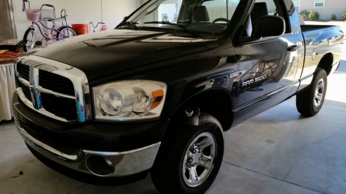

Here's my two finished old lights, back on the truck while I can get my "new" 08 headlights redone.

I will admit they look hazy in direct sunlight, but they done just as bright as before, but now they're not flaking apart lol

Yeah, they're not perfect, but in happy-ish haha. Wasn't much effort or time, so no loss there.
