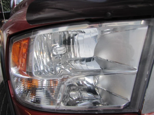

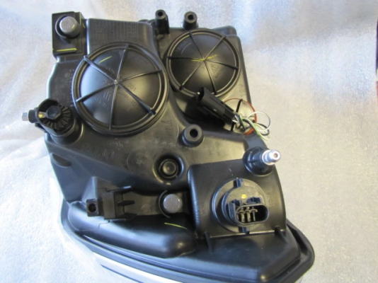

Any actual water would have to enter at the face of the headlight, where the clear lens meets the housing.
If on the other hand, you only have droplets in the face, that is from the VENTs being set to the incorrect position.
the GREY Caps are Vents on this Dodge Ram 1500
vents set correctly
Vents set incorrectly

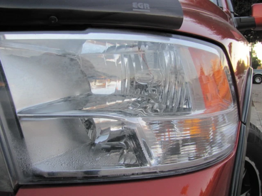

From what i have read:
If you have moisture, as in the image just above
A Hair Dryer used where the Bulbs are inserted, is the best way to dry the head light out.
Some ppl mentioned inserting DRY Packs in the housing, but i have not looked at how that would work
