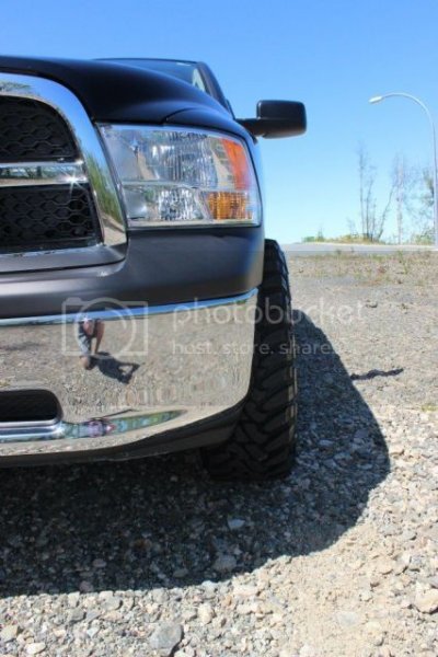

20x10 -24 offset with 295/60/20's will stick out about 2.25-2.5" past the fender depending on the exact tire you end up going with. So yes, they'll be a ways out there. For comparison's sake, here's what 2" past the fender looks like with a leveling kit.

I actually love that look. Would love to know what tires those are, and I assume Bils at 2.8? Spacer in the back? Even if you added some flares later, it would still look good.
That was my old truck. I was running a 2.5" leveling kit (it was before I knew about Bilsteins), 0.75" rear coil sapcers, 20x9 -12 offset Fuel Hostages, and 35x12.5 Toyo MT's. It ended up with a 6" lift and Bilsteins down the road and then I traded it in for my 3500.

any rubbing with the 35's and -12 offset with 2.5" level?

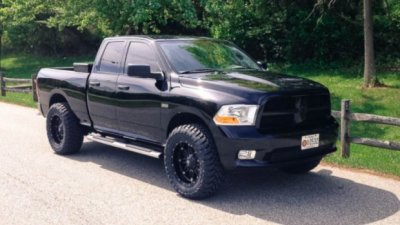

Here's a stance I will be going for as well, only my wheel will be -19 offset with 35x12.5r20
Here is 2.5" front, 1.5" rear
35x12.5r20 with -25 offset. Owner claims it has light rubbing and trimed minor plastic
Rubbed on the back of the inner fender on the drivers side slightly. I was able to just tie back the inner fender with a zip tie and that was enough.

A 20x10 -25 offset with 35x12.5's will require trimming to the back of the inner fender and likely the pinch weld as well.
