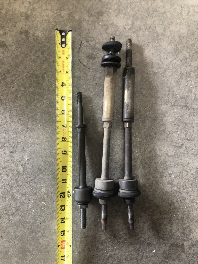

I bought a used 2010 ram 1500 4wd around a year or two ago. The front sway links/bushings were shot so I ordered some Moog replacement links k80894. Went to install them today and they are about 4 inches shorter than the ones that I took off. They almost look like there is some sort of spacer installed on it.
Anyone have an idea what sway links these might be or where I can pick up some longer ones?

Suspension Maxx makes solid front links in different sizes.
Does your truck have a bracket lift? These are proobably made by whoever made the lift.

You could just order the rubber bushings themselves for a few bucks, and keep your existing links. They don't look too bad other than the one could stand a little straightening maybe.

False alarm it was a spacer. Sprayed with liquid wrench and gave it some time and got it off. Thanks for the help.

Those look like the link extensions that come with 4" BDS/Zone lifts.

I want to say I traced a part number on the knuckle back to a supermaxx 4” lift when I first got the truck. They probably use something similar.
