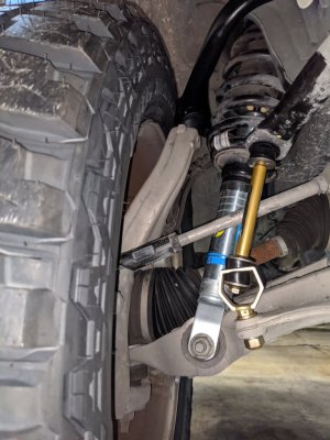

now my upper a arms are rubbing my tire. Not sure how to fix it, truck isn't drive-able. I have factory SRT Ram wheels. Original OE wheels, I'm wondering if the offset is the problem

all but the last picture had the lower spring mount you removed from the OE strut installed upside down creating too much lift
last pic is driver side passenger side are the ones with the tires

anybody got pictures of the bils installed correctly if they are upside down?

Redo the passenger side and check to see if you put the washer in the correct spot and not under the nut .
when installed correctly you dont see the collar that holds the snap ring in place . It will be like the drivers side. If you put the washer in the correct location on the drivers side just use that as the picture you asked for
i see what you are talking about now

Like everyone else said, you assembled the Bilsteins wrong.

its just the one side. I dont think thats gonna fix my clearance issue though
You are at like a 4"+ "level", thats gonna kill your angles. And from what I understand, 35s are iffy on stock wheels. I went with wheel spacers before mounting 35s to eliminate that scenario.

Same here I bought 10mm spacers to be sure I could drive the truck after they mounted the 35s on my OE 20's. They have been setting on a shelf in the garage for years now .

I had stock 275/60r20s and didn’t even have 1/2” clearance to the uca. That’s a 33x10.5. If you run anything wider you need spacers or offset rims. I’m currently running 305/70r18 now but have a -12 offset. Gives me about 3/4” of clearance now. Definitely fix that strut mount though.

Im setting the bilsteins at 2" and 1.5" spacer, should be 3.5 inches installed correctly.
Angles should be okay right?

The correct ones are not the universal spacers with multi bolt patterns . Start with what you know is wrong and pay attention to where you installed the washer on the bilstein when correcting the known issue.
