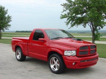

I'm not 4x4 but I've seen more than one 4x4 dropped 2/4.5. Hopefully one of the lowered 4x4 guys will chime in.
One of my favorite dropped 4x4's is this one.

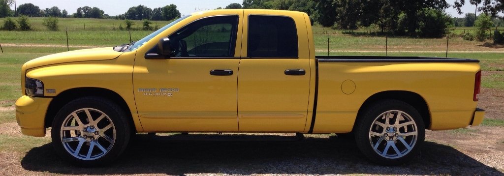

Any one else having an issue seeing the pic^. Maybe it's just my phone.
