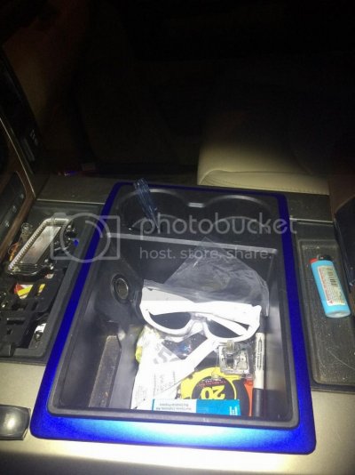

The ring around the open storage is held on by 9 clips: 2 on the front and sides, and 3 on the back. Just use a flat screw driver and pop them off. Not all at once just little by little in each side until it comes off.

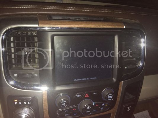

The trim around the vents will just pop out, use a trim removal tool (or flatblade if you're careful) and it will just pop out. The trim around the radio is part of the center stack so you'll need to remove the center stack then tape everything off.

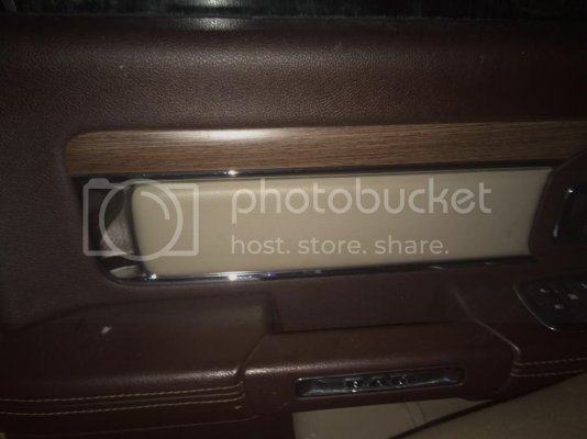

What about the trim in the doors
Cloviz
Cloviz
Feb 3, 2014
214
35
Well that's a bummer...looks like I'll have to put it on with the door attached. Thanks for the help and advice guys.
