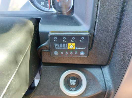

I have a Pedal Commander PC-31, and I couldn't be happier.
The price was right, and I now experience my Hemi just like I recall driving the V8s of the '70s & '80s.
I understand exactly how it functions, no additional HP or torque, but Wow!
You have to relearn how to use the accelerator pedal so you don't leave too much rubber on the road. And, I use the setting of City +4, which is on the lower end of the scale. :cool:
I refuse to own a recent model V8 without adding one of these or a similar device.
For the low cost versus satisfaction, I can't imagine anything that comes close.
