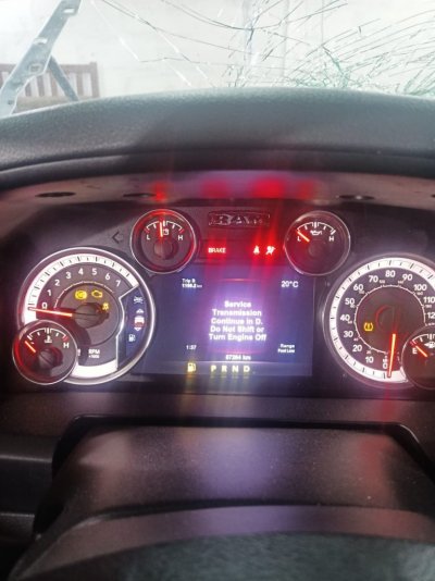

ram 2017 bighorn. there was an accident. the pillows worked. I can't start the car and the following error occurs on the scoreboard.IMG-20210820-WA0020.jpg

Dont know what happened and dont know the extent of damage but the windshield is blown out of it and the airbags deployed so I can only assume the damage is pretty substantial. Not sure I'd want to start it

After an accident where air bags deployed, the vehicle will not start after it has been shut off.

^^^ what @OC455 stated. If the airbags deployed initially the fuel pump is disabled so as to minimize the fire hazard. The vehicle won't start as BCM/airbag module need to be reset.
The vehicle is in no condition to drive, just have it towed.

Must have been one hell of a collision. Where is the hood ? (note left hood hinge is up and no hood attached)
