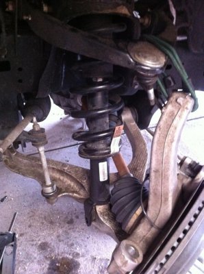

I'm having a heck of a time getting the strut assembly out. Anyone have any tips? I can't get the bottom to clear the control arm. Any help is appreciated I'm stuck here! Should the lower control arm drop lower?

Some photos...
Hell bent steel 2.5" level in front. Overall it took me a little over 4 hours. 3.5 to do the first side and about 40 minutes to do the other lol. Truck rides like stock but looks much better. The rear now only sits 1/4" higher than the front. No vibrations with 4wd either.

Looking good! ! They are a pain to get out and in. Like you figured out you have to unbolt more then just what hell bents instructions say
