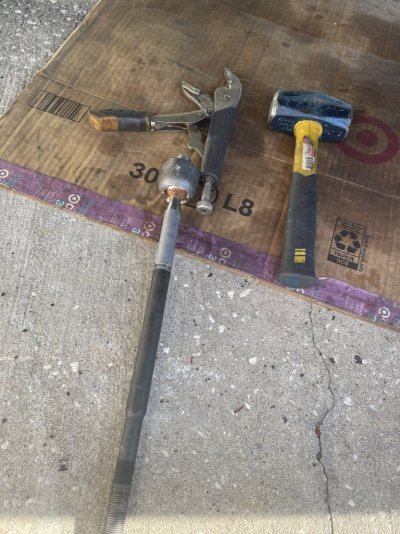

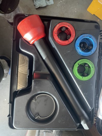

Fellas,
I took apart both sides of the front end with the exception of the upper and lower control arms.

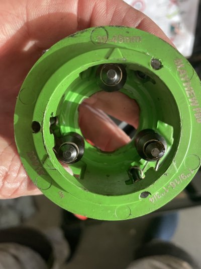

I’ve had a Mayhew innner tie rod kit for several years. I’ve never used it on my 2015 Bighorn until today. I couldn’t get any of the adapters to fit over the end of the inner tie rod. The green one was the largest size and I couldn’t get it over the back of the inner tie rod. So I had to put a pair of locking pliers on it and hit it with a lump hammer to loosen them.
That’s not gonna help me when it comes to tightening it up and getting the correct torque setting. Does anyone know if Mayhew has a larger adapter to fit these inner tie rods? Or for that matter, is there another kid that will fit these inner tie rods.
I also have another question about that clamp that holds the rubber boot at the back. Obviously this was a one time use clamp. Does it matter what type of clamp I put at the back to hold that rubber boot in? What have you fellas used?
I’m also gonna clean up the rust in that area before I start putting the new front end parts in.
Thanks for any helpful tips!

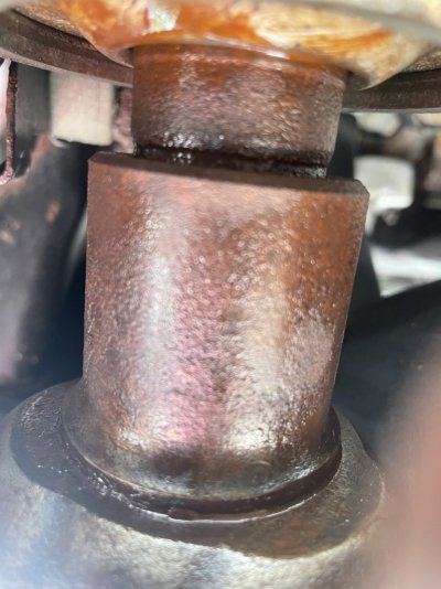

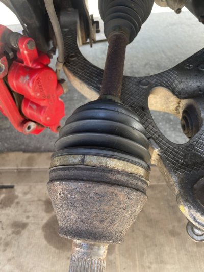

I was looking at the end of the axle. There’s a fair amount of rust. It’s got 160,000 miles.
Would you guys replace these? Or just clean them up and put a preservative over the rusty areas?
The rubber boots are intact.
Thanks!

Fellas,
What tie rod tool have you been using for the inner tie rods?
I need to find something that will fit this inner tie rod.
Thanks!
Thanks!
Wire brush the splines clean then give them a good coating with anti-seaze
